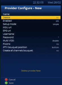

kiddic slyk1hd 5.223
iptv bonguets maker 7.3 the newest 1 ::
View attachment 24882 View attachment 24882
Customised boot/reboot screens
THIS IS taken from suls site FOR IPTV COULDENT GET EASYER EITHER RUN THE IPTV SCRIPT OR JUST PUT YOUR (PASSWORD -USER) IN THE suls iptv bonguets maker 7.3 in the plugins
Configuration
Start the plugin and then select configure to set general options
Select providers to configure providers
Press the green button add a new provider or press ok to edit an existing provider
Enter at least the name and press green to save. For entering long urls instead of using the remote control it is recommended to edit the config file
Configuration
