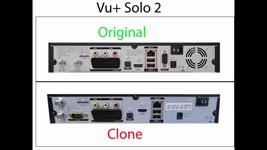

Try installing the latest vix image for your box, if it doesn't install, then your box is a clone ??
use google images to check original from clone box also underneath,wonder how many posts state to use 8gb max size for flashing boxes?
