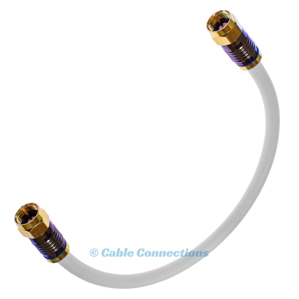

However I tried to connect it the vermin white box in my house and it doesn't have the right connectors!
The white box doesn't have the pin to screw the splitter into, it has the same connection port (sorry I don't know the correct terminology!) as the splitter.
Is there anything that I can do? I'm in desperate need of help! Thanks guys.
You will need cables like the one below[emoji106]View attachment 23947
Sent from my iPad using Tapatalk
Ohh ok! I bought one "wf100" to plug into my zgemma! Should I purchase another one for the splitter, or use the one I have and purchase a different kind of cable to plug into my zgemma?
