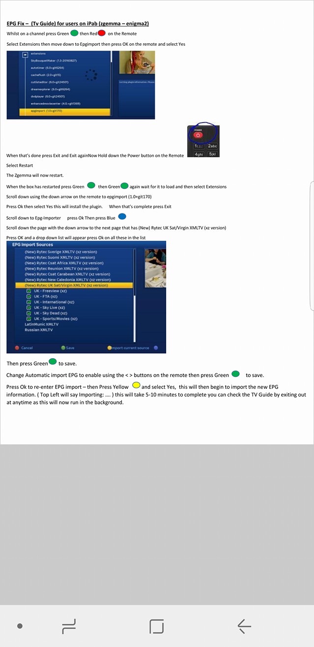

This is for ipab but don't think it will differ much
Many thanks for the guide I think I may have found the problem when I scroll to download EPG import the version is EPGIMPORT (1.0+git134) where as the version on the guide you provided is EPGIMPORT (1.0+git170) I assume I am unable to download the correct updated version of EPGIMPORT.

you should see a source towards the end of the list (new) Rytec UK Sat/Virgin XMLV (xz version) and that's the one you need
Yes you will need the newest version of epgimporter. What image are you using?

Think it's changed again eol is at the end and new at the start
That's what it was before it changed to xz version, have they gone back as I thought eol meant End Of Life. strange.
Edit: Just updated to git170 and still got the xz version sources on my VU. will check the zgemma's later
you're right, some of the sources were prefixed eol 1/1/2018, denoting when gz file are no longer in use,afaik all the rytec sources in recent vix images, 5.0.029 on I think, are now using as you say xz files, if anyone is seeing eol before source, then they're using gz files still. the new files combine UK & Irl both sat & cable, the older versions have seperate files for each
Sorted thanks for everyone's help.
In the end I had to update to newest wooshbuild version which it then lost my line so I had to try and find out how to do that again. Once it was up and running I followed the above guide and it's running great again. Thanks for everyone's help
