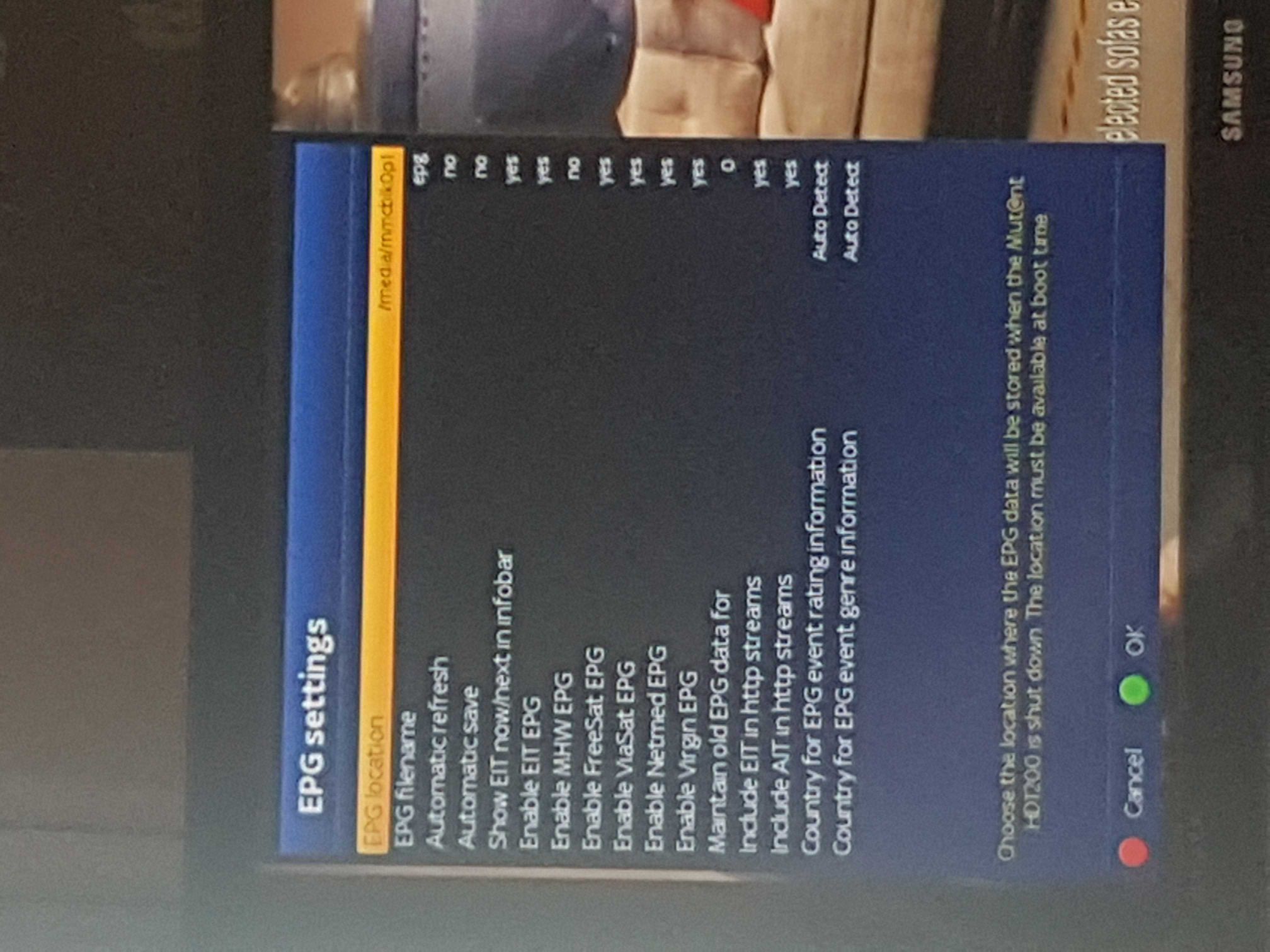

Go into the EPG section in menu, setup, and post a picture.

Ive managed to find the epg settings in the menu the following states:
Enable EIT EPG: Yes
Enable MHW EPG:Yes
Enable Freesat EPG:no
Enable ViaSat EPG: no
ENABLE NETMED EPG:YES
Maintain old epg data for:0
There should be a line where it says EPG location. That should be set to your storage device, not internal flash. You also need to set up the plugin your box is using to download the EPG. So you need to find the crossEPG plugin, and go into the settings. There, you can set when you want it to download each day.
Cheers buddy, the configuration on the cross epg menu was disabled so enabled that to download everyday and tv guide has populated the listings.
