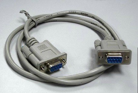

if ur box was not showing ip then use rs232 cabel connect box with pc run universal dreamup loader click on connect then switch on dreambox and install image + bootloader this process will take 30 to 40 minutes for installing image.

Hi mate. Won't work through browser and tried with a null modem using it with a USB adapter as don't have a 32 port, just don't recognise it. Having a right pea souper.
my friend u install and run DreamUP_patched_by_forhike_and_natas 2ndstage loader with DM800_repair first run on pc dreamup then connect rs232 cabel with pc and box click on connect at dreamup then switch on ur dreambox it must connect with dreamup loader then run DM800_repair after this click on flash select & install image after done type ip in explorer which was showing at dreamup loader then install bootloader and reboot ur box
