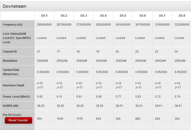

  7. muso17
    muso17 Registered
    6
    0
    1
  8. pabloescaban
    pabloescaban TK Veteran Forum Supporter
    3,527
    1,646
    133
    {builder
    power levels are ok, what splitter are you using?

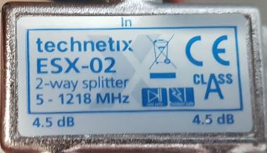

  11. muso17
    muso17 Registered
    6
    0
    1
    oops sorry. I thought you meant splitting just the modem cable.
    The splitter is the one they installed. Its been fine up to now. splitter.jpg
  12. pabloescaban
    3,527
    1,646
    133
    {builder
    the splitter is also highly unlikely to be at fault as technetix are about the best for VM, which only leaves the cables to/from the splitter or it's a provider issue, try a test line and see if it improves
