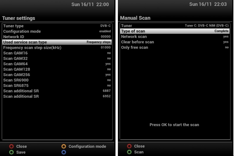

Reckon this will work? saw elsewhere somebody else was having trouble with a GB with cable, gonna give it a go.
