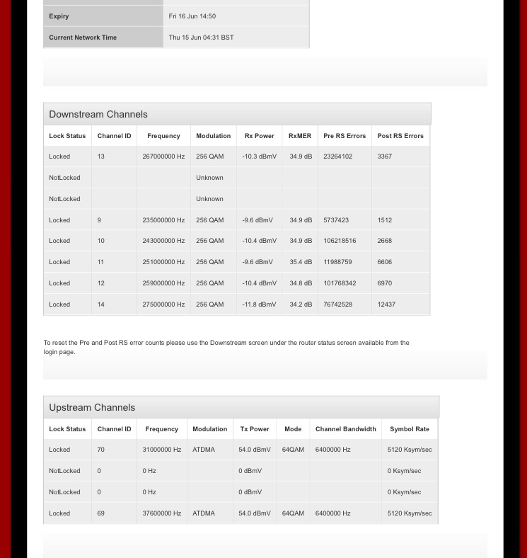

Are you connected to anything else as well as the router? if so, i'd say plug it straight into the router and test again and if it's within tolerance, yes - a powered splitter may help but if it's the same with the wire plugged straight into the modem then give VM a call and tell them to check your levels as they're below tolerance.
