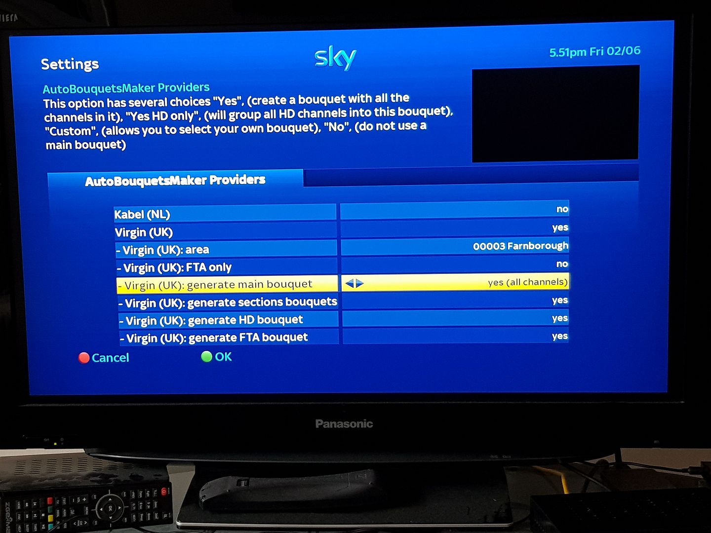

This is what I put in ABM
What am I doing wrong?

Auto bouquets e2 is for satellite only boxes - this build has abm which you seem to have found but before scanning for channels you need to go into your tuners and disable the sat one if it's not being used and make sure you enter correct net id for cable then also in abm you need to set area in here too and select which providers you want to scan ... you should find around 380 video channels.

I have tuner A sat disabled. I tried to follow the virgin guide to letter
I near Woking, surrey, and used NETID 00003 from the list
Woking Surry NTL 00003 643.000 6.887
