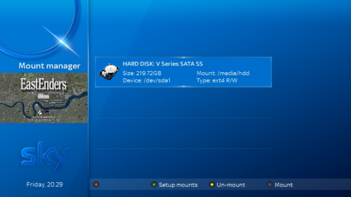

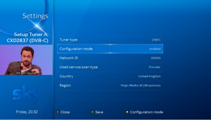

Sorry, my picture is a Mutant HD51, I haven't got a H5.2TC connected up at the moment.
I was just trying to show that the HDD mount should be /media/hdd and ext4 R/W and how the tuner should be set up in Tuner Config.
tuner a needs to be of if you not using a sat dish on it, then tuner b and c need the same settings in both of them
Disconnect the HDD and leave it disconnected, restart the box.
Go to Plugins > USB Format and follow the instruction, then restart the box.
Then go to Mount Manager and set it as /media/hdd if it isn't already.
