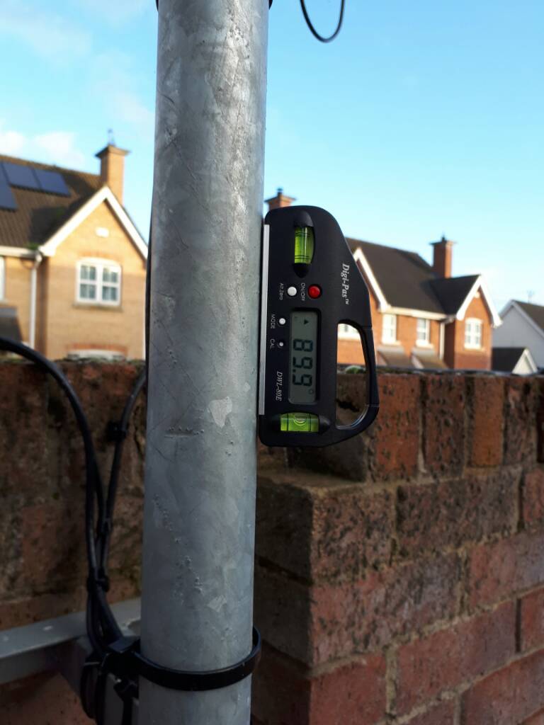

I used 1.2 traix dish tacomate motor and invacon l.n.b 15inch t.k brackets and 2.inch pole I followed the c.a.i guide to motorised systems
Sent from my SM-A520F using Tapatalk
Do you think TK brackets are stronger than "L" mounts?
2 inch l bracket has six fixing holes I use thunder bolts I had to use t.k.brackets as.i.had to mount the dish on the back wall in the garden l also use a.digital level with a magnetic base
shoulda plumbed it a bit better, ;)
