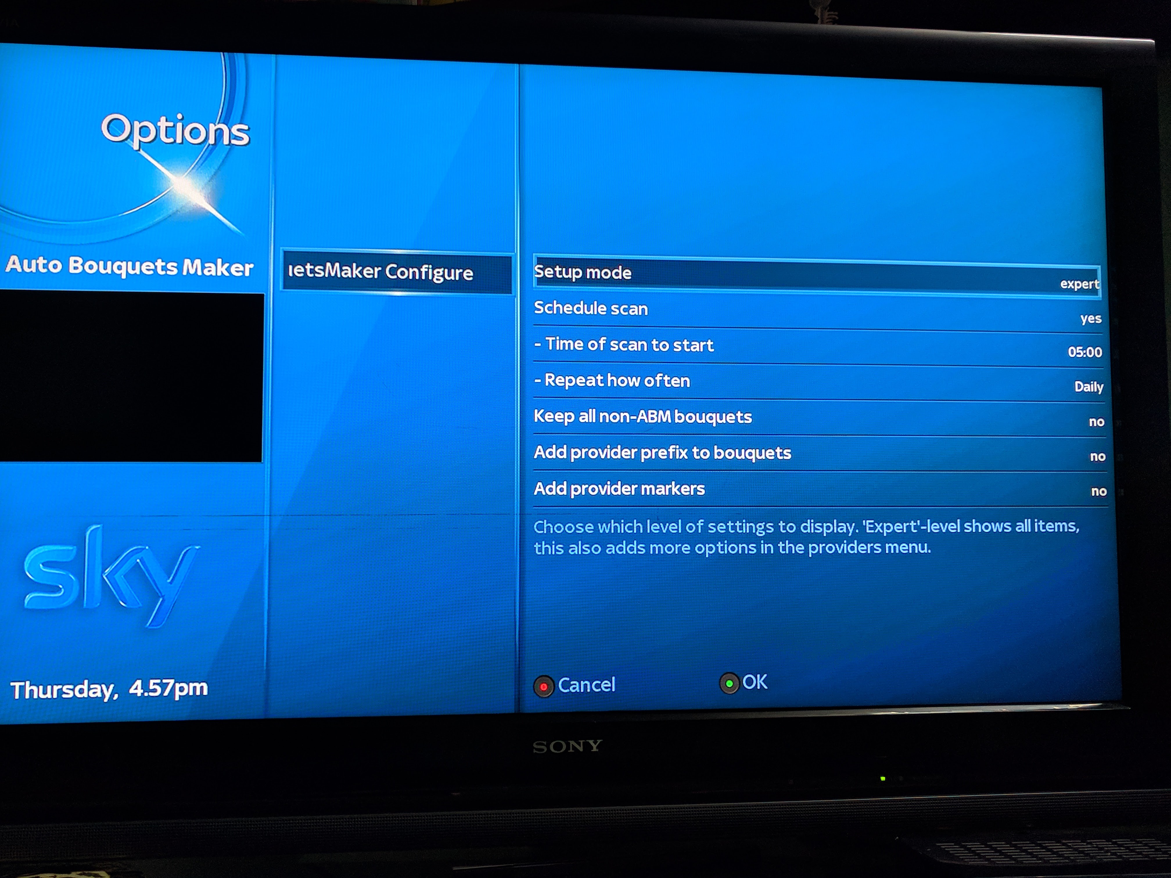

No you don't, you either scan via the service searching menu or via ABM but not both - ABM should be configured to do a daily scan.

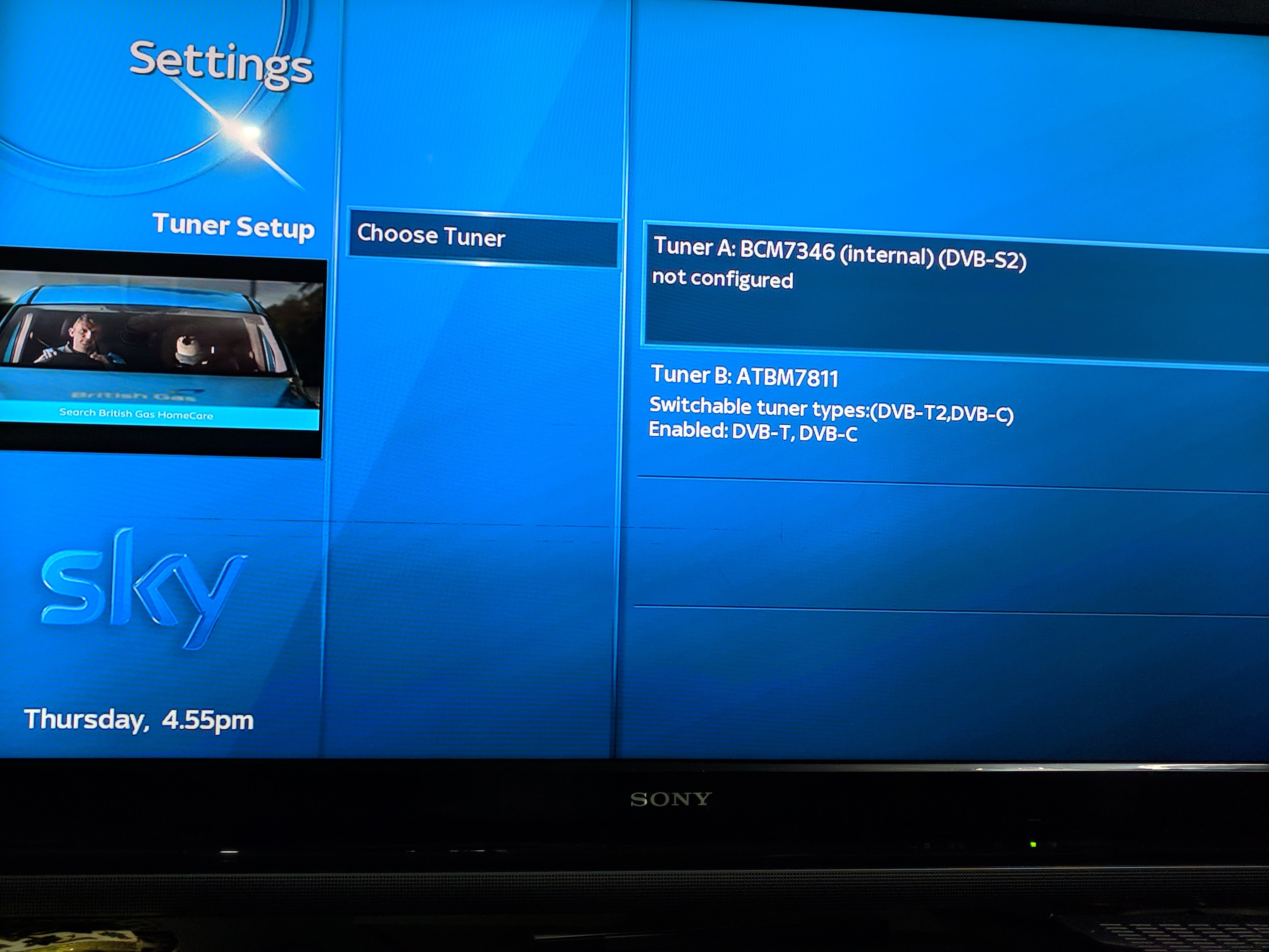

If you're not using any of the tuners, once you've changed them to not configured, you need to press the green button so it saves this setting or it will revert back. The H2.H only has 2 tuners (1 satellite and 1 cable) and not 3.

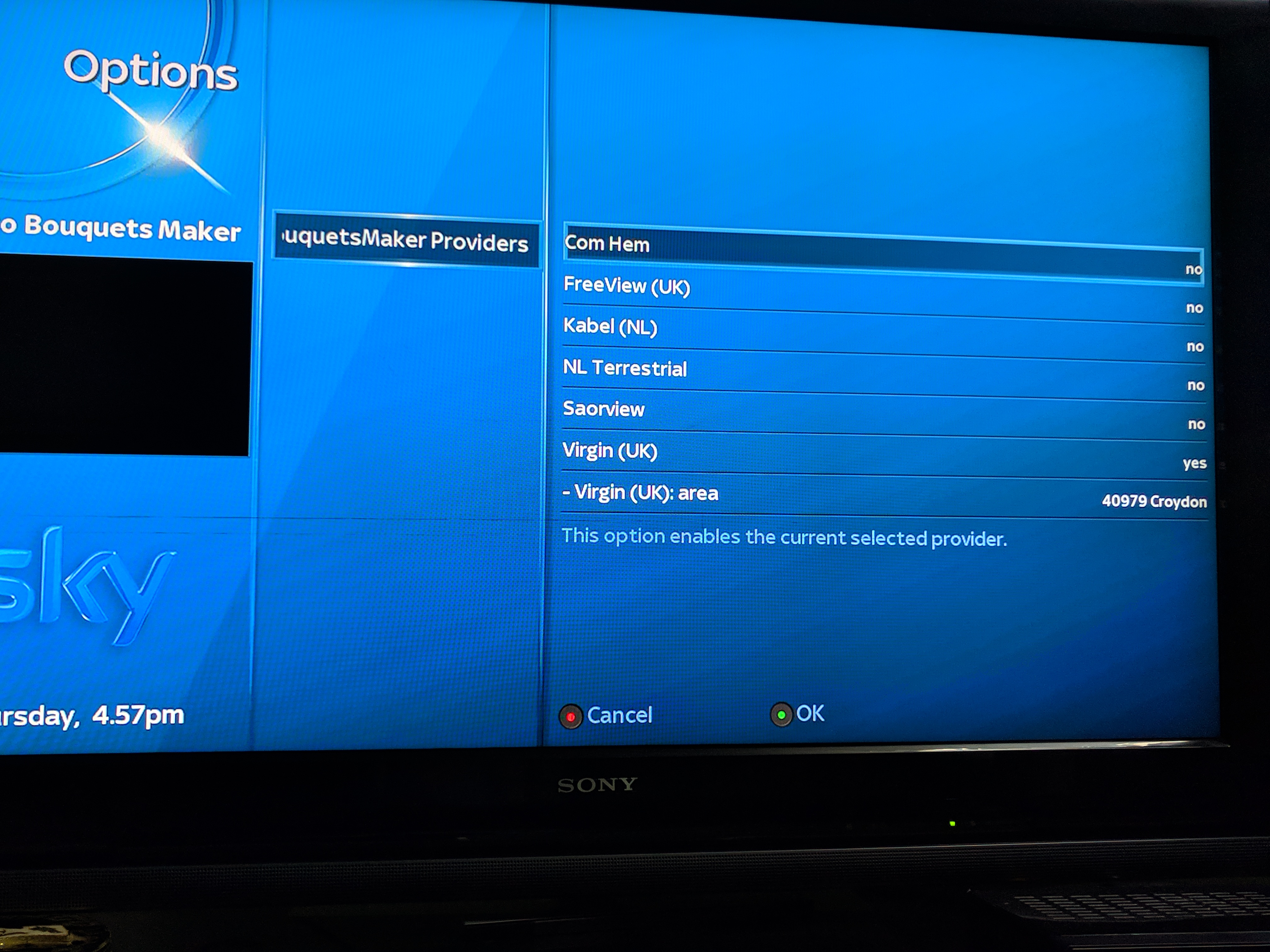

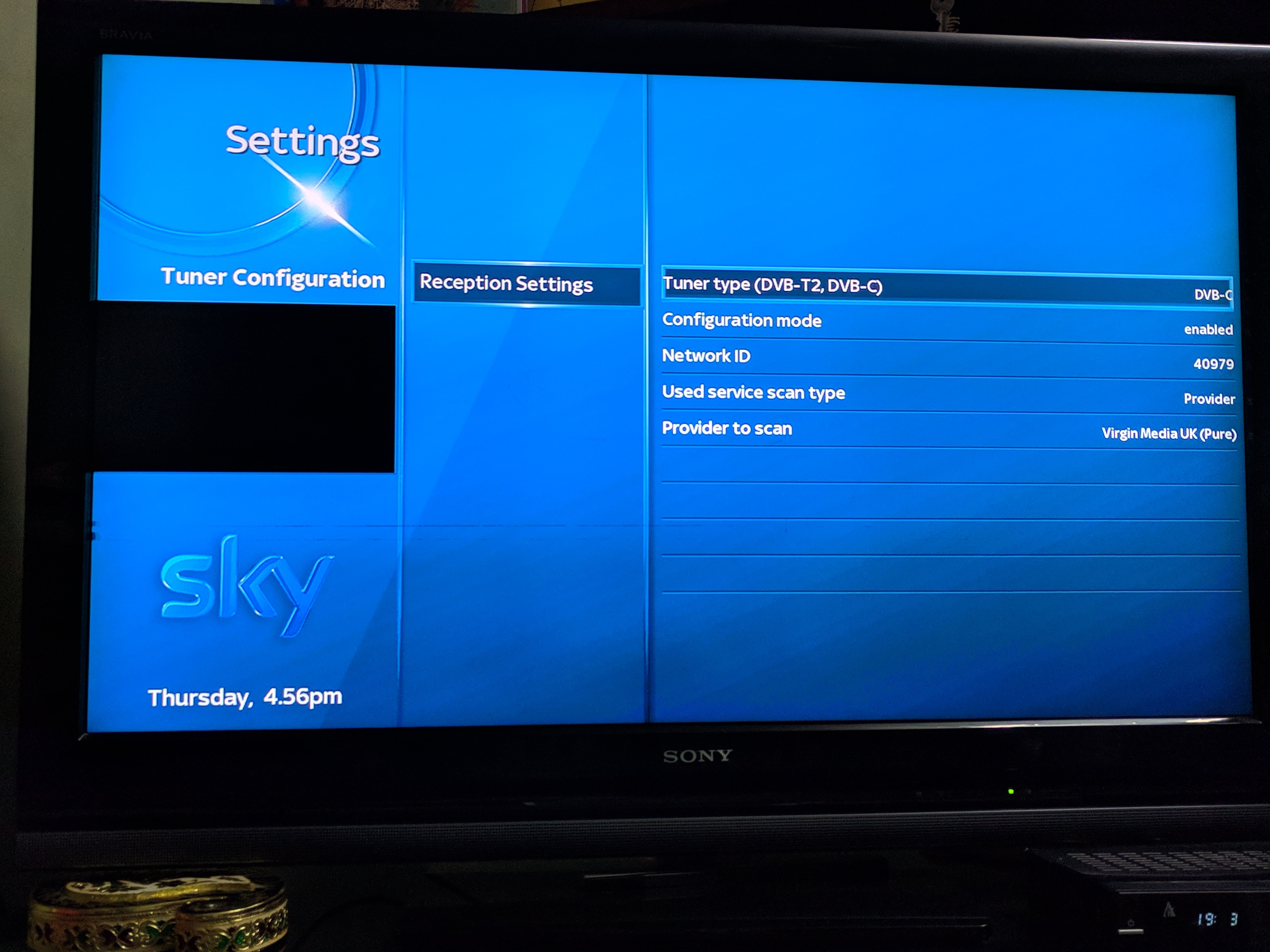

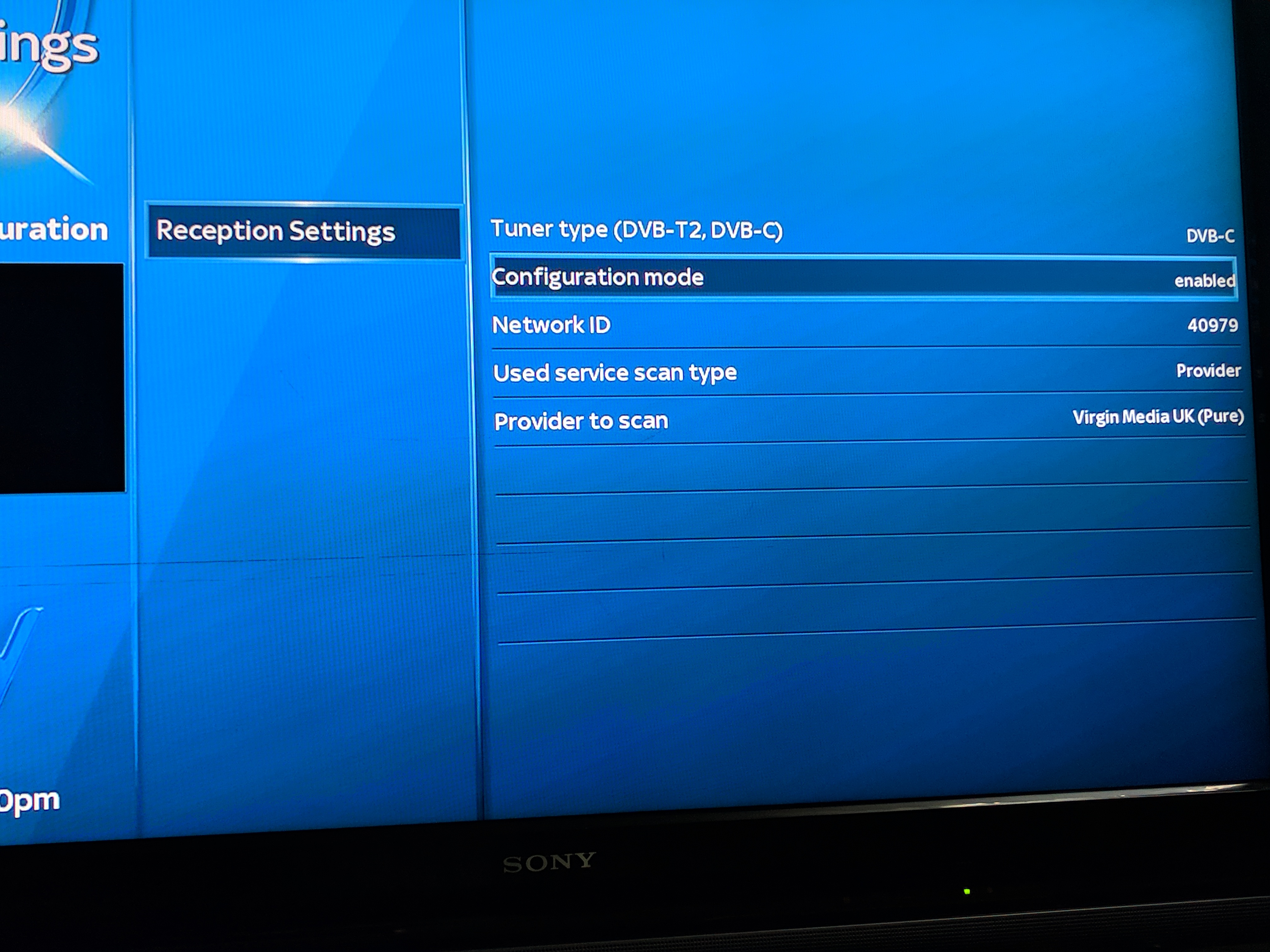

Some images would help of what you can see in tuner config and your settings etc.

Hi Ste,

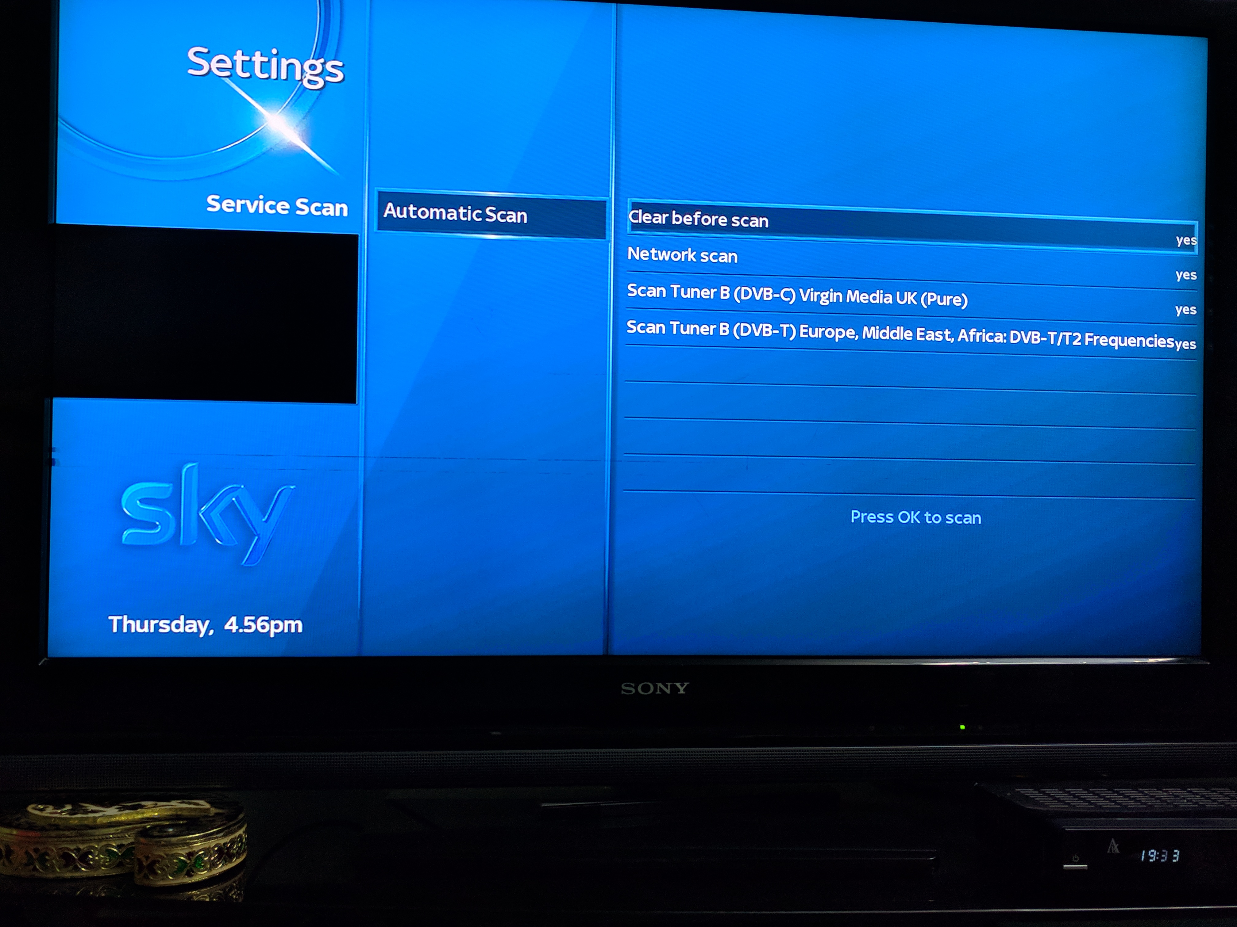

Please find a number of images that hopefully are helpful in understanding what I am doing wrong!
Kind regards BL.IMG_20171102_165553[1].jpg IMG_20171102_165621[1].jpg IMG_20171102_165643[1].jpg IMG_20171102_165720[1].jpg IMG_20171102_165735[1].jpg IMG_20171102_170037[1].jpg IMG_20171102_170351[1].jpg IMG_20171102_165720.jpg IMG_20171102_165735.jpg IMG_20171102_170037.jpg
You have changed provider to scan to V*rgin Media UK Pure - I just leave it as cable brute force which is detailed in my guide... maybe this is where you're going wrong.
There is only 2 tuners listed though in your picture on tuner config.

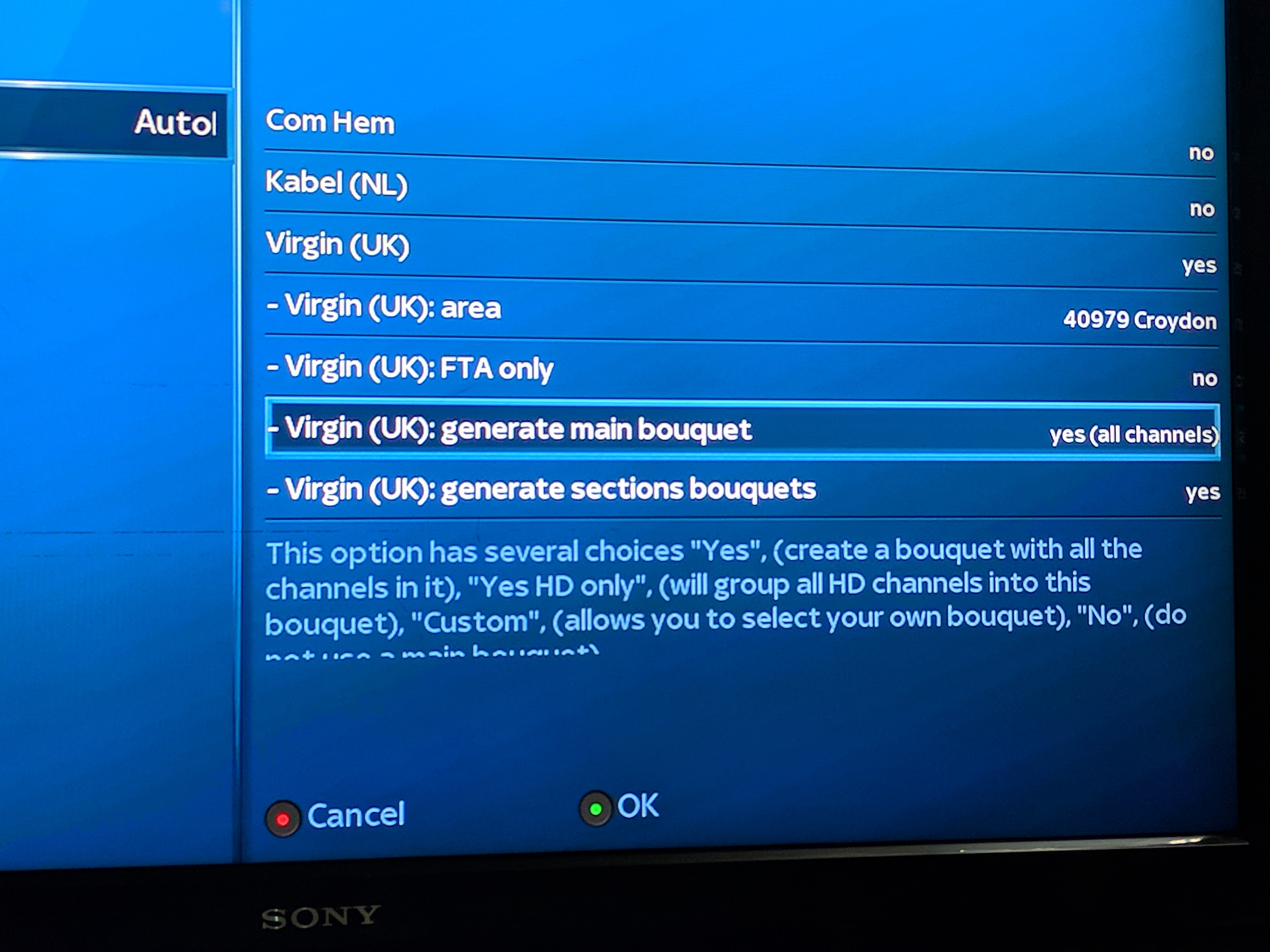

If helpful I have attached some screenshoot from ABM settings for your perusal.

Don't do a scan in that section with cable brute force, just set that in tuner config under provider to scan press green button to save and exit out. Scan with ABM - if you're having trouble, you may have the wrong net id - there's several for that area so if you can't get the right one from a genuine TiVo box, you'll have to try them all.
THANK YOU Ste!
Managed to resolve the issue.
The Network id, although correct for my idea was not the one on the V box. I checked the id on the box and once Zgemma was updated, all the channels worked.
