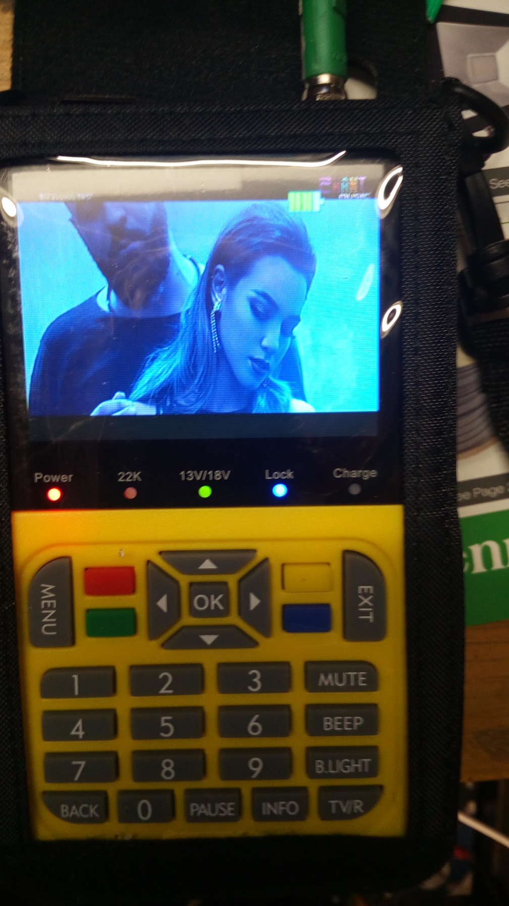

Its basically a free to view tuner with tv screen and installation tools.
Cheaper than a realignment fee after a storm. (Isnt that always the way).
Nice one. [emoji2]
Basically, yep.
Easier than lugging the TV outside, lol
And better than using webif on phone as see if the actual picture is pixelating

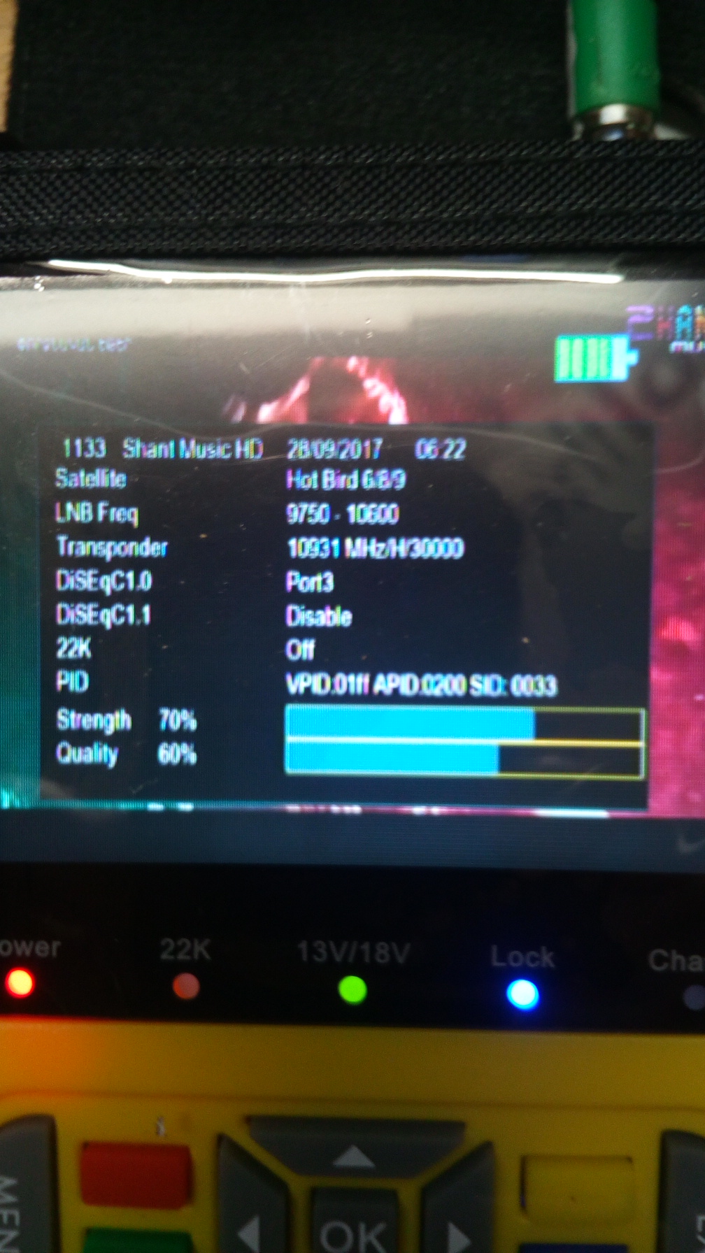

Having an absolute nightmare this weekend, put my TV on yesterday morning to watch the spurs game on m futbol and the screen was blank, no signal. 28.2 was fine on the other LNB.
I have a single LNB on the arm of the dish pointing at 19.2 and a quad LNB cable tied on to it pointing at 28.2. had a look at it and it looked like the heavier quad LNB was pulling at the single LNB and must have knocked it off position.
This morning I decided to switch LNB's and put the quad back on the arm and point it at 28.2 and cable tie the single LNB to that pointing at 19.2. I was doing this in the kitchen as I can see the TV from the dish in there.
Found 28.2 no problem and then cable tied the single LNB on to that pointing at 19.2 but m futbol wasn't clearing, checked sky Germany and that was working fine. Gave up in the end and switched my box back in to the living room and now I'm getting nothing on 19.2, aaaaaaaaarrrrrrghhhhh!
When I hook the feed from 19.2 in to my receiver I get 0 signal strength on 19.2 but when I connect the feed from 28.2 in to my receiver I get huge signal strength for 19.2.
My head is melted, anyone any ideas where I could be going wrong?
First picture is the signal strength I was getting in the kitchen for 19.2 (but no m futbol) and the second picture is the signal strength I'm getting if I hook the feed from 28.2 up to my receiver that is tuner config'd to 19.2.
have you changed over your diseqc switch settings?
also, thats not the correct TP for M-futbol, 10818 V 22000
what receiver are you using.?
I had problems with my F5 dropping out TPs ,mainly on 13e, but some on 19 as well, I thought it was me messing about and moving LNBs that was the cause,
then when I accidentally put the multi-sat list on a V8 I was setting up for my kids to watch freesat on all the missing channels were on it,
my F5 was simply slowly dying, :(
I double checked on my E2 box in living room and all the missing channels were on it too,
Also , the 2nd pic is showing signal strength on 19, doesnt mean its tuned to 19, just the strength its getting from it,
remember, you will get a signal from 28 for almost 2" off movement, well I can anyway, its really strong, so maybe your dish is pointing at 23 or something, and you are halfway between,,,,, ?
