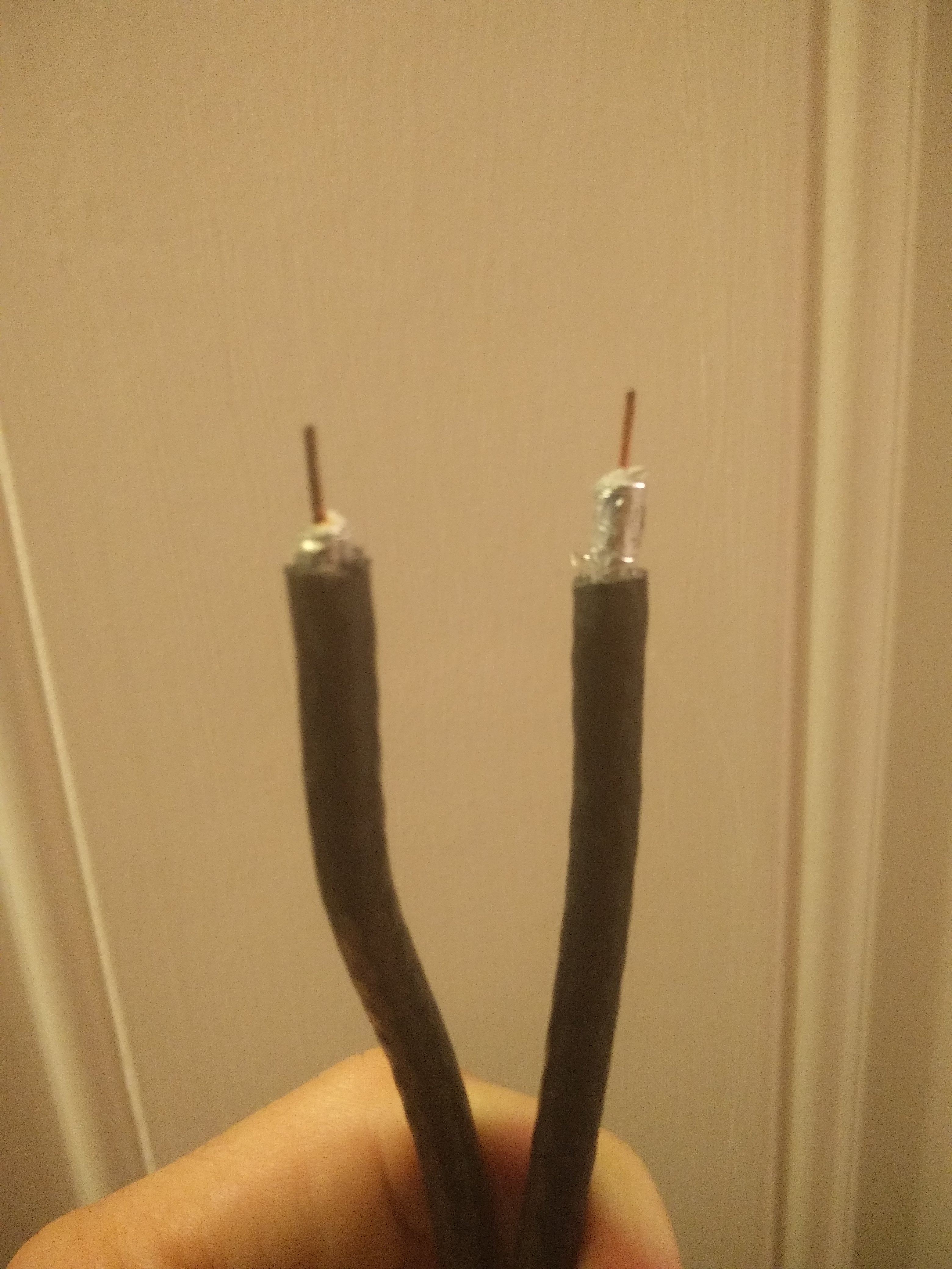

Had a chance to go out and have another look and it appears to be a cable issue alright, hooked the living room cable up to the 28.2 LNB and my amiko and nothing.
Never happened before , what usually causes cable to fail like that?
Various reasons - if it's been twisted a lot etc. could have got water ingress over time but cable does generally degrade over the years.... how long has it been in place?
Try stripping the ends back and remaking the connections first before looking into replacing cable.
Not long at all then - not enough time for it to degrade that much anyway. Was it thin cable like the shotgun type?
