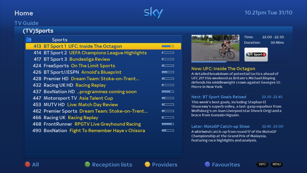

A number of sports channels have disappeared from the main sports bouquet and now only clear via the non indexed bouquet.
These channels are
At the races
Eir sport 1
Eir sport 2
There maybe others, but these are the ones ive noticed.
