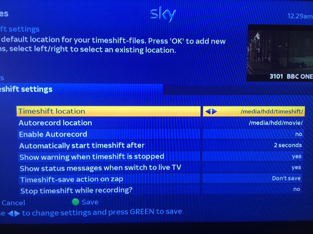

Something eating up HDD in the background
Timeshift save action on zap. Put it to don't save.
Does seem rather bizarre it's doing it

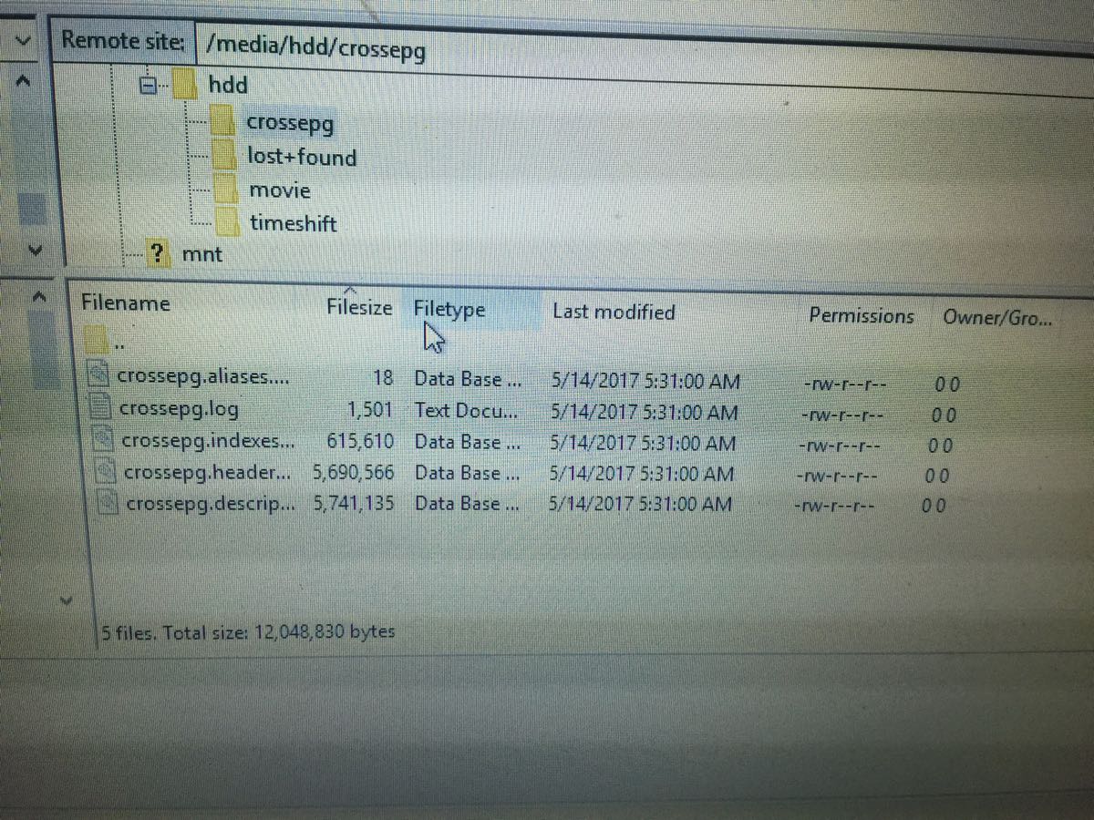

These are the sub folders in the HDD, nothing in the other folders

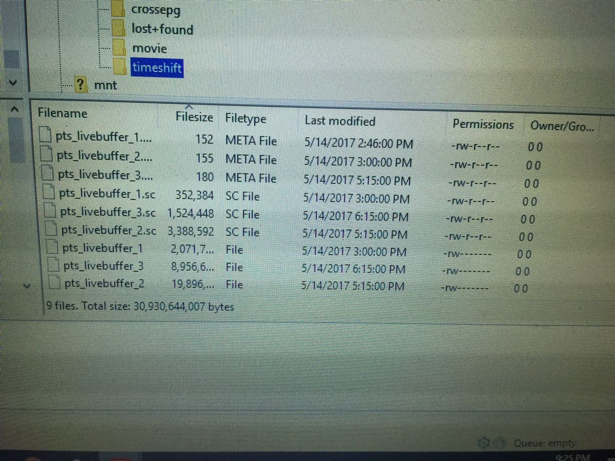

That should do it looking on your screenshot you have alot of timeshift files. What it might be worth you doing is initializing and converting to ext4 again
Sent from my SM-G935F using Tapatalk
Or deleted all the timeshift files in FTP.

Deleted all the time shift files and it's back up to 97%
Don't understand it, why is the time shift taking up so much memory, only reflashed the other day and don't use timeshift that often
Because of that setting timeshift save action. It's basically saving all your timeshift files whether or not you've used it.
But turning that to don't save it will only keep the timeshift for the channel your on.
When you change channel it will start again but delete the previous channel timeshift

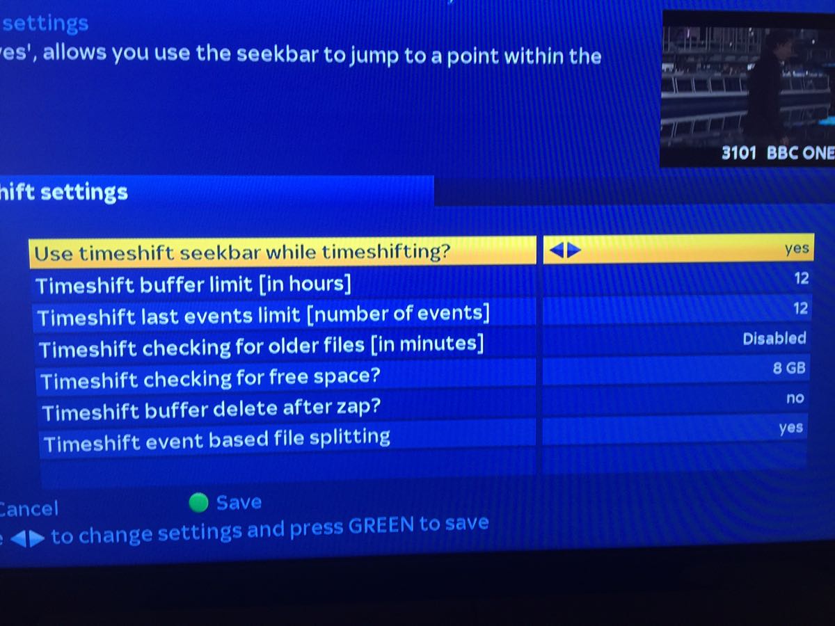

Timeshift buffer limit. Set to 1
Timeshift checking for older files. 30
Timeshift buffer delete after as. Yes

With your current settings it's trying to save 12 hours of timeshift, it's not looking to delete any either.
Also forgot to add change the timeshift last events to 1 also.
So your new settings will be as follows; it will only record 1 hours worth of timeshift, once changed channel it will delete buffer, it will also delete any timeshift buffer, and it will only create 1 buffer at a time.
You will be up and running then mate
