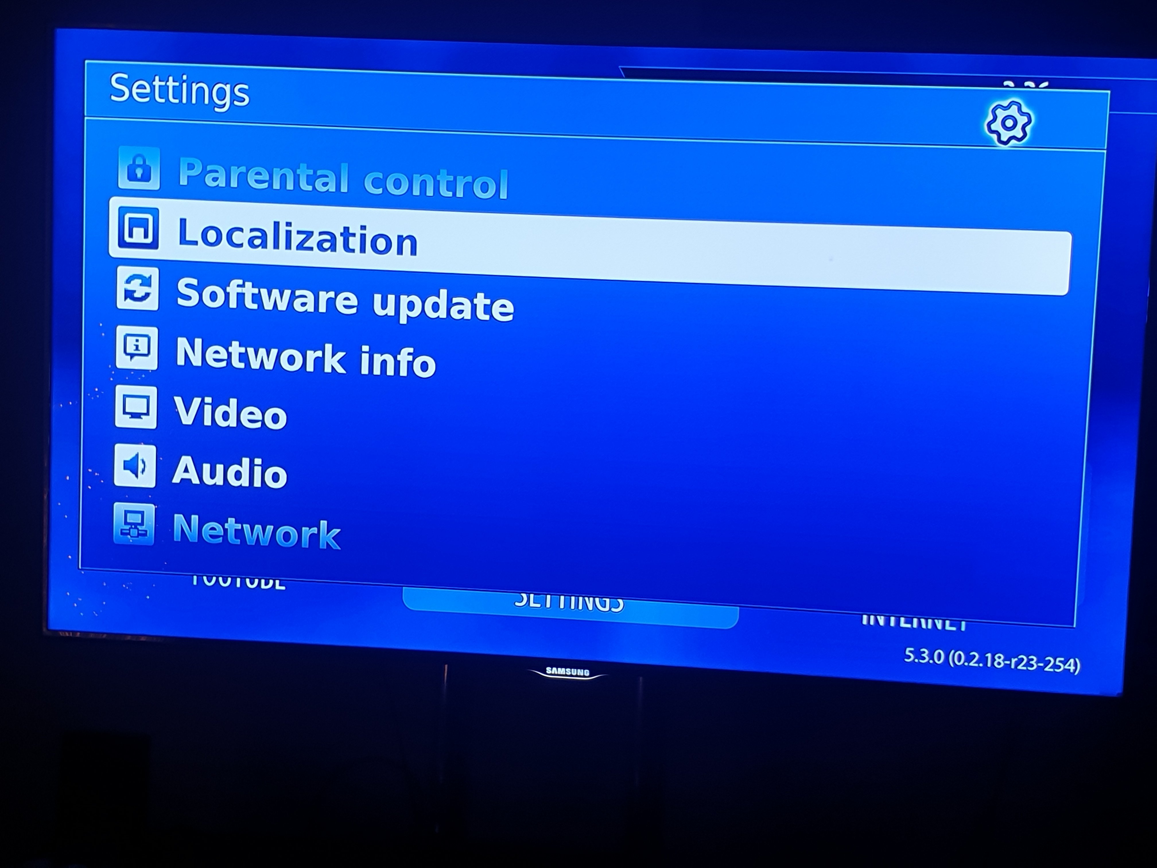

Because I have reset the box the settings i have is this..when the box restart it goes straight to the live screen the option for portals are not there no more
Go to SETTINGS then click GO TO THE INNER PORTAL and press OK, the click on SOFTWARE UPDATE and press GREEN, then RED to force update, the box will reboot and you should have portals back.
