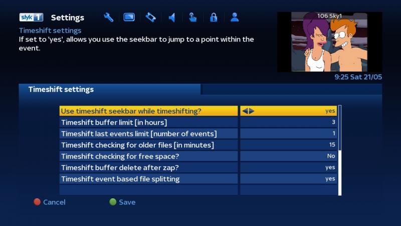

Timeshift files should automatically be removed once you change channel, if they aren't there is a setting which needs changing.
These are my settings which only allow for for one timeshift recording before being replace by the next. It checks every 15 minutes that there are no old ones and gives m 3 hours worth of timeshift on a channel.
Also upon testing, when you put your box in standby the timeshift stops and the file size no longer increases. When you bring the box out of standby they file size starts from 0.

wooshman - based on your settings - what i dont quite understand is, is the buffer deleted after 3 hours of timeshift?, so if you wanted to use timeshift immediately after the 3 hour mark, you wouldnt be able to rewind much, as the file is reset? On the basis you havent changed channel shouldnt you have a constant 3 hour rewind ability? Great work btw the way, very impressive.

With OpenATV, I can only speak for this as it is all I know, it starts from the point of the channel starting and records 3 hours, or 4 or whatever you have set it to. At any time in that time slot you can go back to the very beginning. Anything after that and you an only go back to the start of the new 3 hours.
I have not fully played with timeshift, I just know that 3 or 4 hours is normally enough timeshift. You will sometimes get a message telling you about timeshift reaching the end which is the 3 hour duration. It will give you a enu to confuse the hell out of you and then what it does then is anyones guess. One option is "Just close this menu"... what happens to the timeshift then I don't know.

Thats good info, my timeshift feature was filling my USB stick up and then stopped working. I have just used the settings as per the pics in this post so hopefully will solve my problem.
