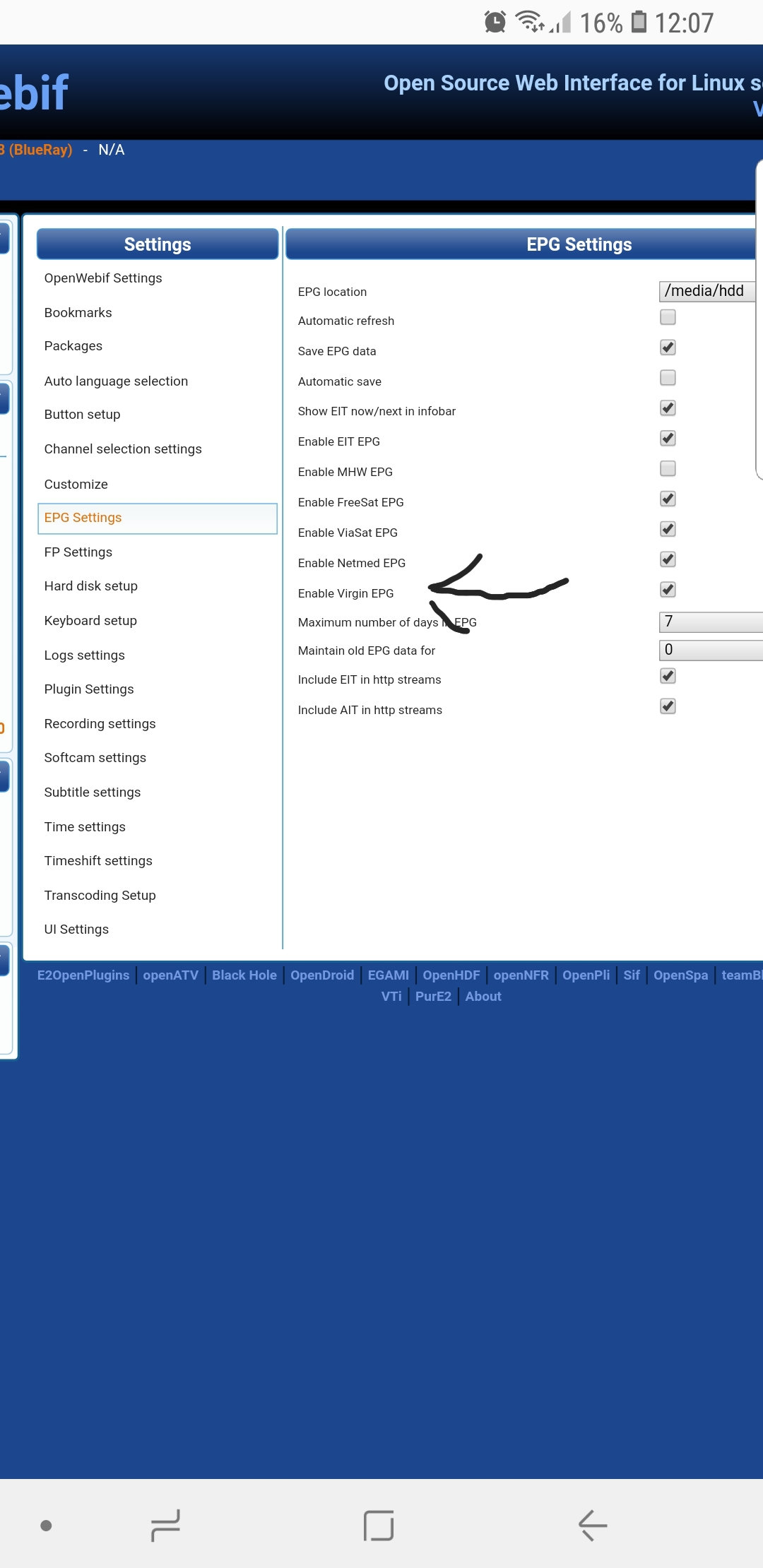

this is what i'm currently set to use, and what WB infinity set up automatically during install.
yes it's virgin using the slywb skin
I meant in EPG menu there's settings in there to Enable Virgin EPG
After enabling that delete EPG then try channel 100 for 5 minutes.

mtv music, paramount SD and aninmal planet HD all have the correct data in my epg, using the same Rytec and base build as you, openatv6.2
do your settings match mine if you have EPG data for those channels?
no, mine is set ot this (which is what WB infinity set during install)

ok well i don't understand it then.
mine is a clean fresh install of wb infinity. epg settings seem to be same as yours, yet i've got channels with no data at all.
could it be region/area related?
It will probably be disabled to stop corruption between vm feeds EPG and EPG import.
You could also try deleting both EPG and ABM bouquets.
ok i've enabled it, deleted epg file, and went to virgin channel.
after about 5 minutes it's imported "some" data, but still huge gaps. BBC1 and 2 have now/next but anything at 3pm is blank.
103 and 104 has full data.
animal planet HD now has data, but current data for D+1 is missing.
