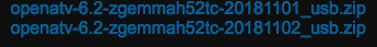

Down the zip file for the H2H: http://images.mynonpublic.com/openatv/6.2/zgemmah2h/openatv-6.2-zgemmah2h-20181116_usb.zip
Open the zip file and copy the zgemma folder from the zip file onto the USB. Don't have anything else on the USB.
With the box turned off and no other USB devices or micros SD cards plugged in, plug in the zgemma USB stick into the front USB slot under the front flap.
Turn the box on.
When you see the front display say USB / UPDT press the front power button once. The front display will now change to FLSH
After a few minutes the box will restart.
If it doesn't start up format a different USB and use that
If it still doesn't start up, try yesterdays openATV image, if that doesn't work try the day before that.
http://images.mynonpublic.com/openatv/6.2/index.php?open=zgemmah2h
