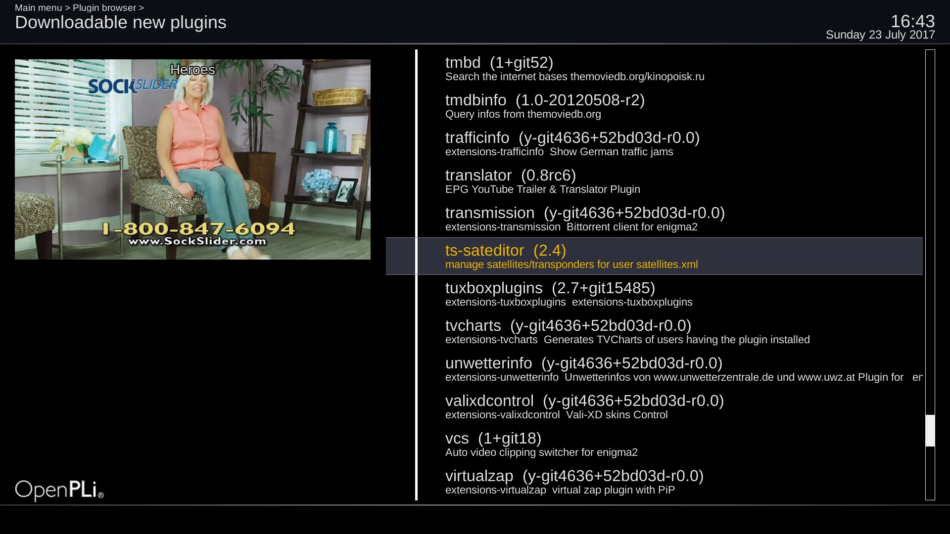

There is also an editor which will allow you to manually enter and store transponder information in the receiver. This editor cam be found in the downloadable plugins under extensions. (see attached)
About the best you can do for now is to build yourself a good satellites.xml file, or get one that somebody else has built. Importing channels someone else has scanned is also an option. Good to see you enjoying the H7! EB

The transponder information is usually stored in two places in the enigma2 image. The satellites.xml file, which contains all the transponders for all the satellites is located in 'etc/tuxbox'. Transponder information for the channels that have been scanned will be found in the lamedb file located in 'etc/enigma2'.
