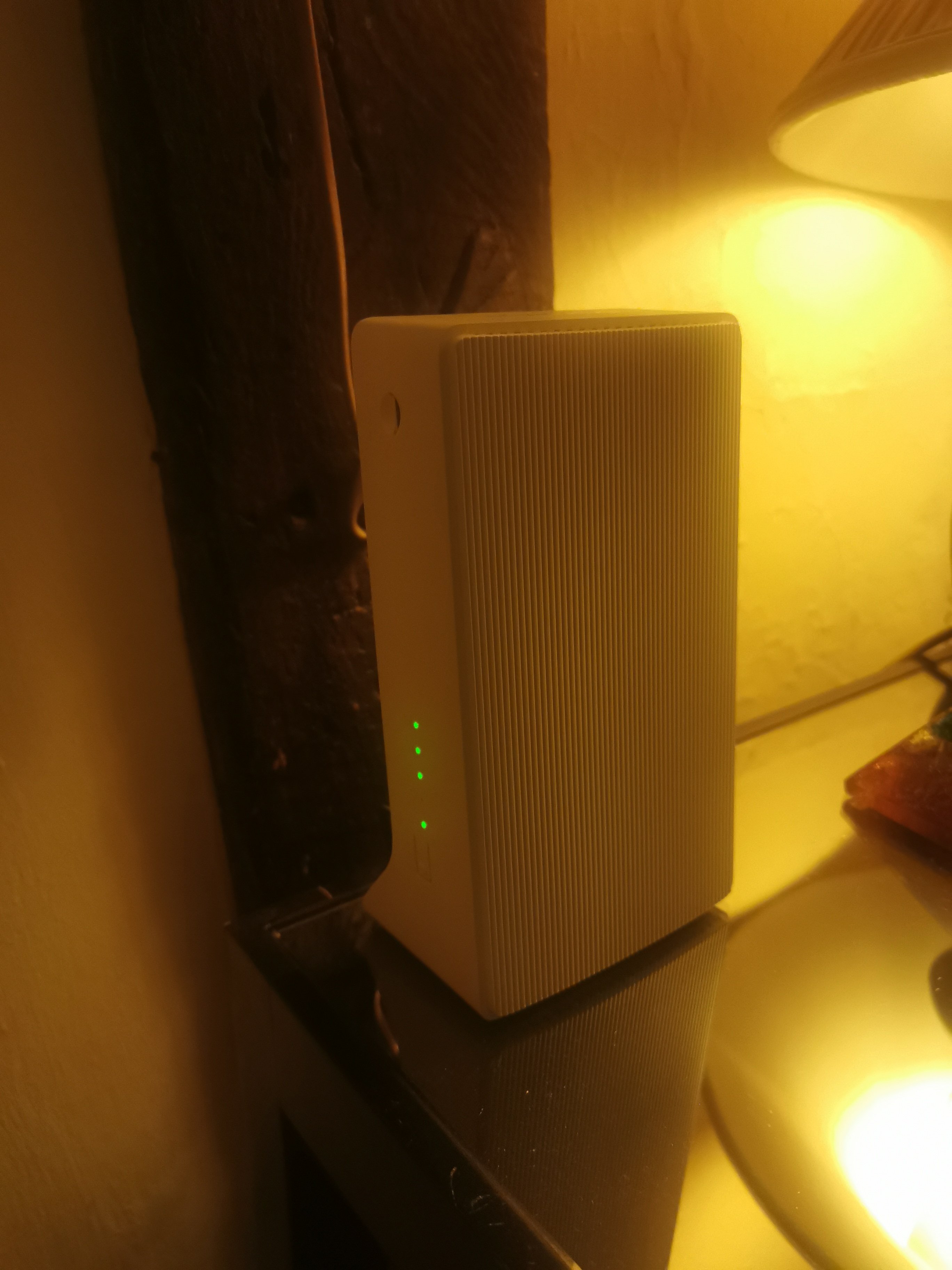

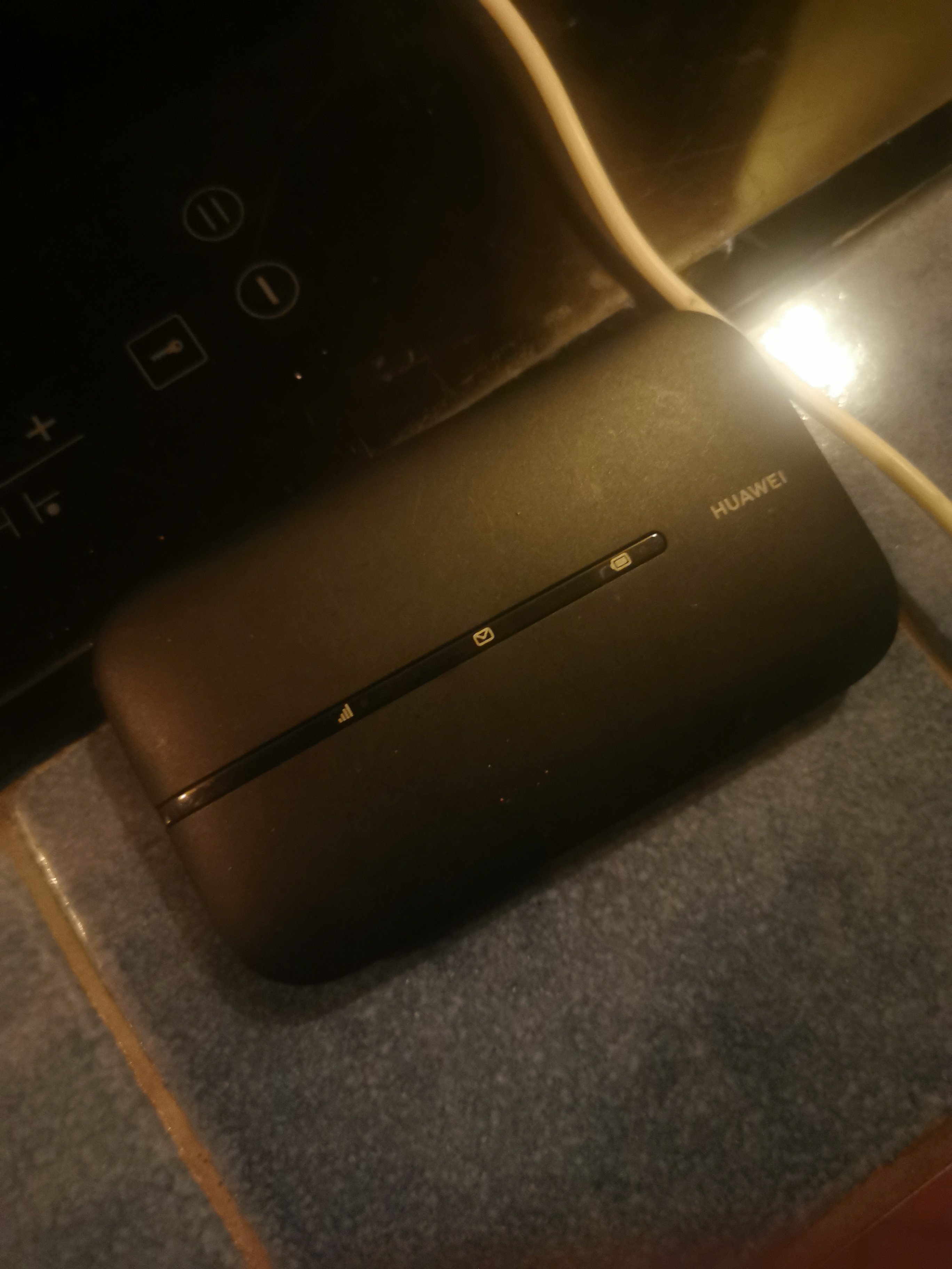

So I was only getting 15mb download w Vodafone in my area so got rid of it and just used my travel Myfi Dongle in the living room (25mb)
I thought if I upgrade to a property 4g router and hardwire it to Firestick I should be cruising

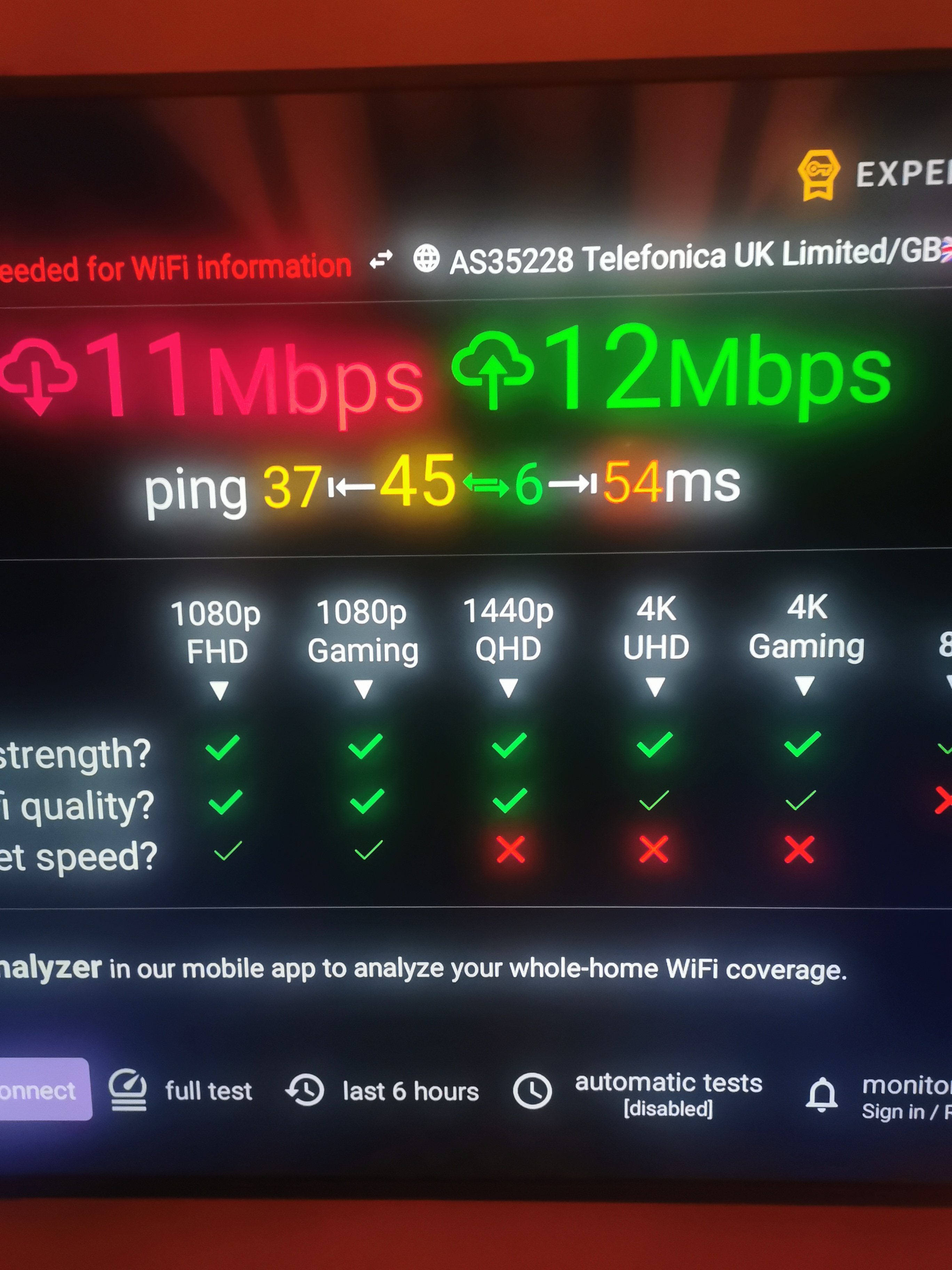

Well, somehow the opposite happened. I hardwired the Mercusys MB110 next to the Firestick 8mb Download..
I then set it up where my dongle was and went wireless.. 11mb
Tests were done on Analyti app on the Firestick
What am I missing and how can I improve this?

I am on WiFi on my phone and using fast.com on the browser, I put my phone next to Firestick. Or should I be doing this exercise next to the router? (They are 5 feet apart)
4k seems to be playing without buffering which it was definitely doing with my dongle in the same place so not sure why?

Do tests on different devices and at different speed test sites.
Don't take one result as gospel.
Google told me 6mb
Every other site said above 30mb, this is within 20 minutes and 4 or 5 tests on each website
Have to tried putting the modem/router in a window from the pictures it does not look as though its located in a window. If you locate the router near a window usually the connection speed it much stronger. I have tried a number and my 5g router could get 600mb and my 4g router could get 100mb.

It's depends what WiFi it's has in the router like WiFi 6. A few feet away should be fine. Is Vodafone the strongest cell signal where you live? Try up stairs rooms as well to get the strongest cell signal. Also try lift your router up a little to clear the window frames. It can make a big difference. Once you have found the strongest signal then try connect the firestick via WiFi again.
