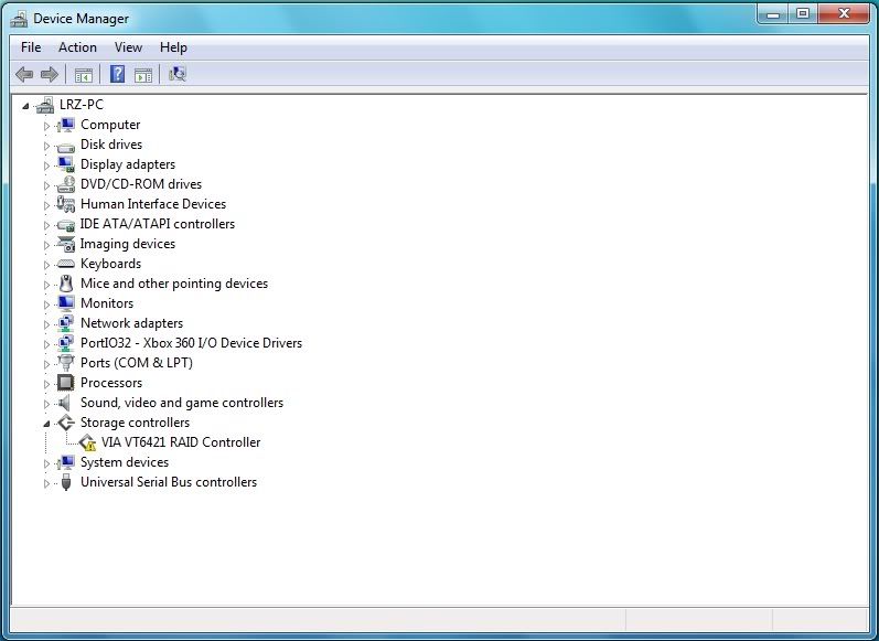

First you will want to check a couple of things.
Make sure the VIA driver is not installed by checking in Device Manager. Notice the yellow exclamation mark.
You also need to have PortIO and .Net 2.0 or higher installed. PortIO is included with Jungle Flasher and .Net can be obtained from Microsoft.

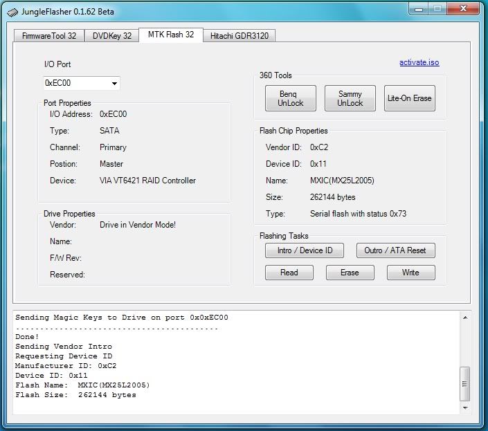

Start up Jungle Flasher and go to the MTKFlash 32 tab. You might have to change the IO Port to find your BenQ.
Once you find it, you should see the properties listed under Drive properties.
Since this is a stock drive, you will want to click BenQ unlock and you should see the following in the picture.
Notice the Flash Chip properties and now the Drive properties says Vendor Mode!

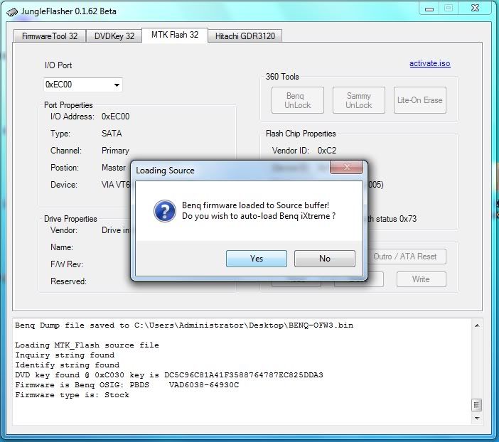

Go ahead and click READ and once it is complete Jungle Flasher will prompt you to save your firmware.
Save your firmware in a location where you won't delete it or lose it!
Jungle Flasher will prompt you to autload iXtreme firmware. Click YES.
This is the result of clicking YES. Jungle flasher will autload iXtreme 1.6 for BenQ and spoof your information over.
Double check your original firmware to make sure you have a legitimate key.
