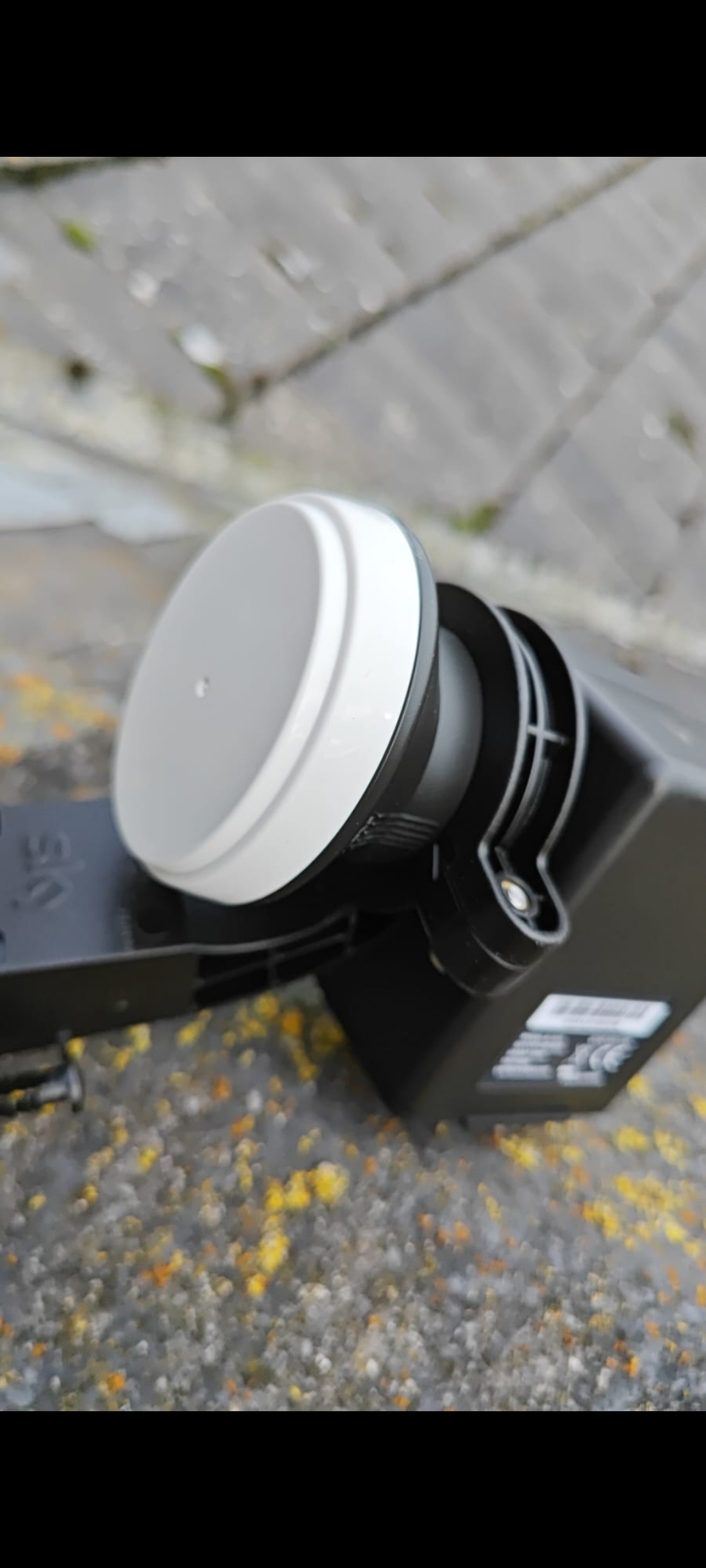

We know there is signal in the bedroom. Try the other receivers in the working location ( bedroom). Upload pictures of the LNB, maybe he forgot to connect the wires as you suspect. Hopefully, he did not use a quattro LNB.
LNB attached below. He will be coming back to remedy the situation this week but I thought if it was something simple I could save the man a trip. I've no way to access the roof though.

That picture isn't clear enough.

Yes plausible or damaged, can you not take a picture from underneath to see how many cables are connected to the LNB ?
I have no access to roof unfortunately. It's a 2 storey house and my ladder doesn't reach that far unfortunately
