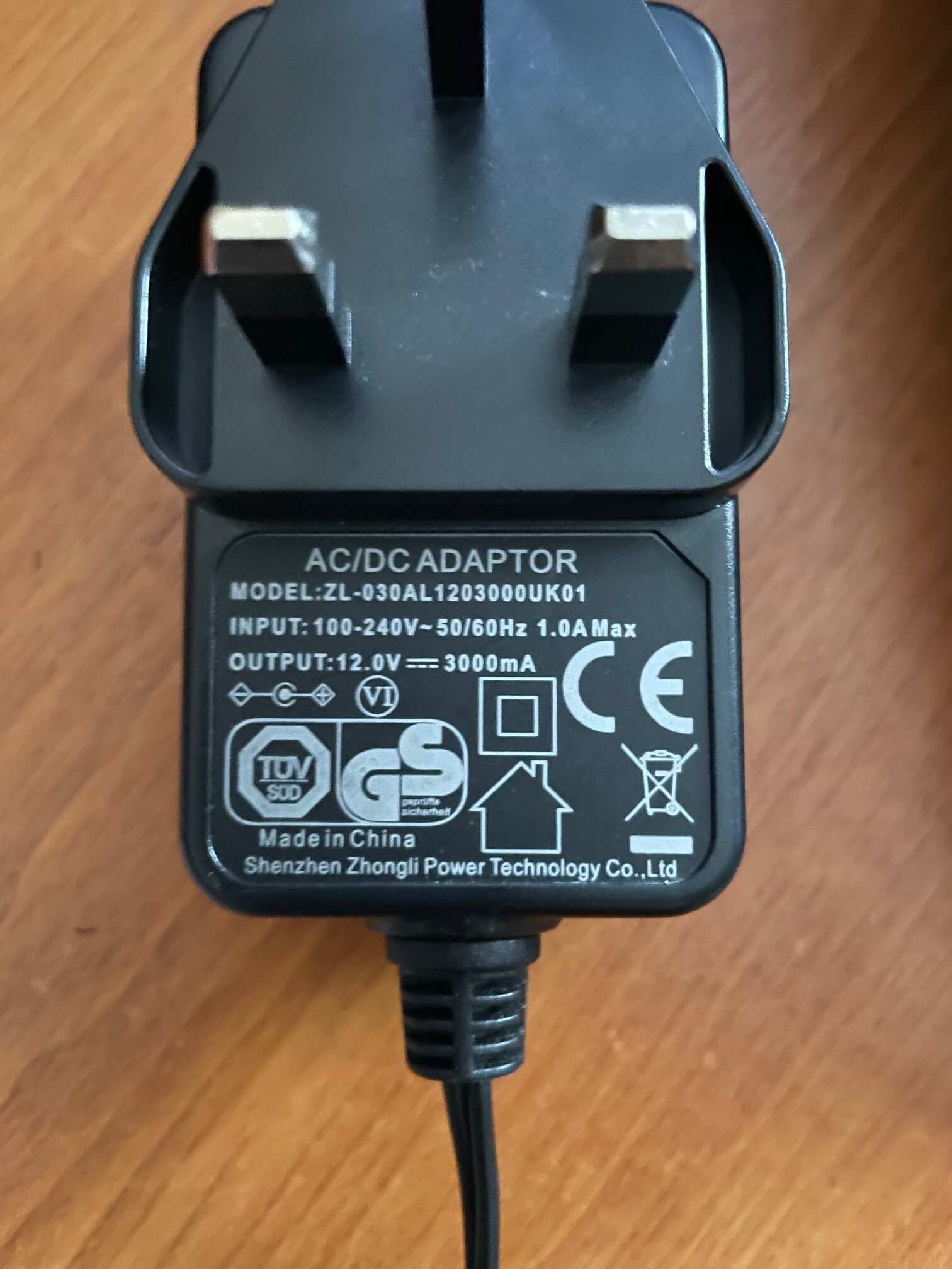

This is the PSU from the latest box, note its 3 amp.

3000mah is 3A
I'd be looking at 6 amp minimum, especially if using externally powered drives or trying to move a dish etc
