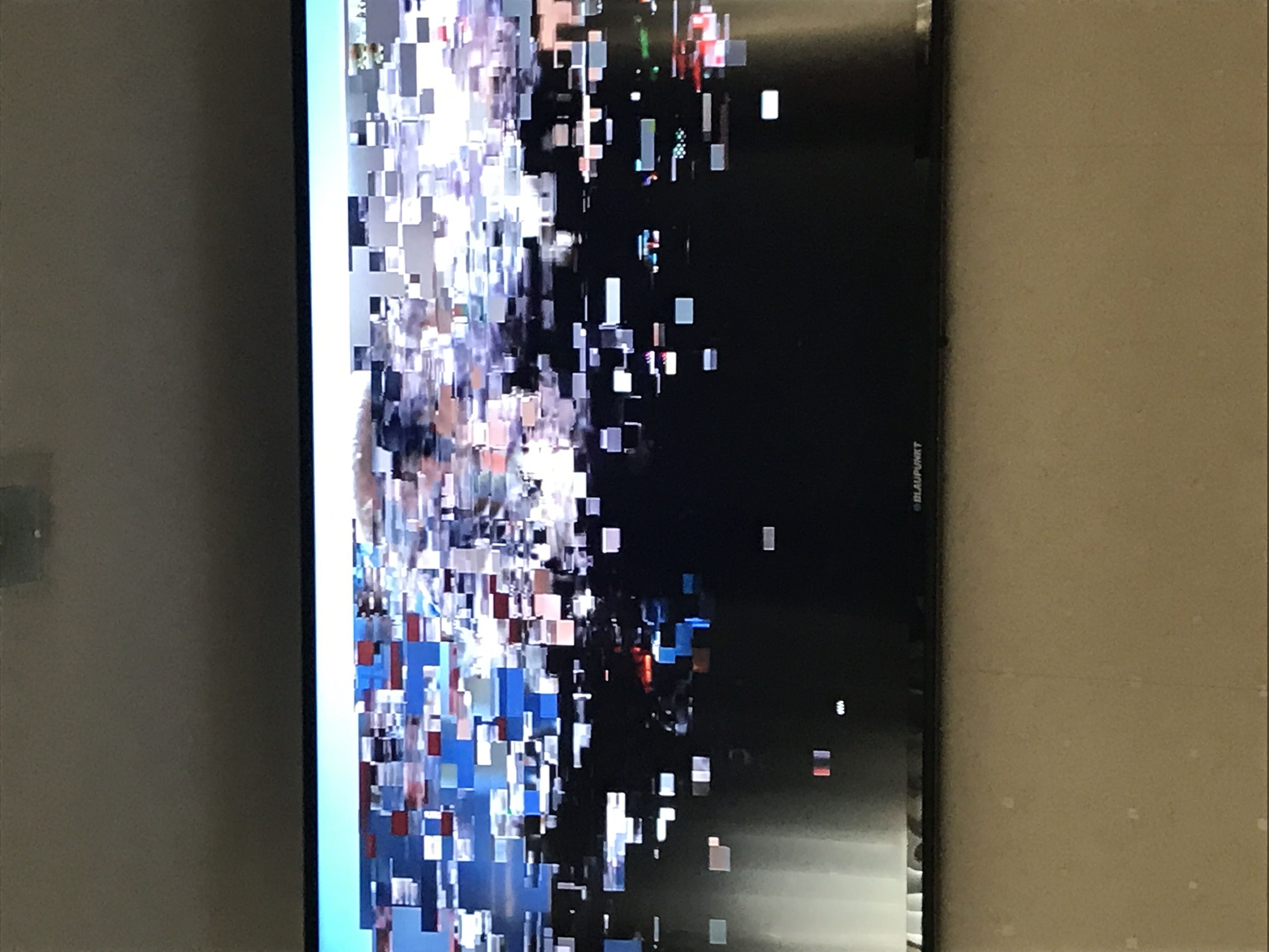

This is what my channels look like
@scottijones Either the cable isn't connected to the box, or the poor splitter will act as a break in the cable.
Try a Labgear splitter from Screwfix, or get a Tratec or Technetix, almost all other splitters are useless for CATV
Im using a triac full frequencey splitter and have been for years. This is a new thing that has just happened and ive lost every channel
if your line had expired, you'd still be able to scan for channels, the fact you can't means the box isn't connected to the cable, either VM or the splitter has cut the connection
