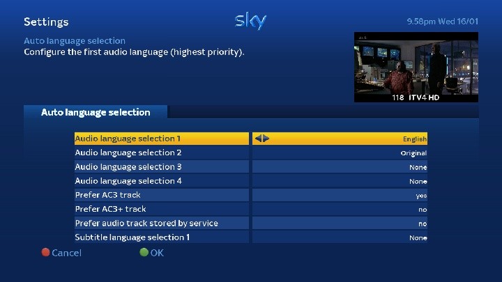

what's the correct box audio settings to stop the audio description being automatically selected on some channels - specifically at the moment ITV4 HD ?
wooshbuild and i've not changed the audio settings from the defaults.
currently they are
if i press yellow and manually change it to track 1 then the audio description stops, but if change channel and go back to ITV4HD it's set back to track 2 again.

In my auto language settings, using grogbuild, all 4 of my audio language selects are set to none, prefer ac3 track is no, prefer audio track stored by service is set to yes.
I just checked itv4 and my downmix settings are same as yours but I have stream 1 selected and am not getting audio description
Yes with stream 1 selected there is no AD, but it keeps defaulting to stream 2.
And ABM is fully up to date.
cheers grog68 just changed my auto language settings to the same as what you posted and its fixed the audio problem on itv2hd and itv4hd thanks alot
