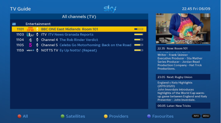

BBC2 seems to have gone AWOL but all these work FTA
