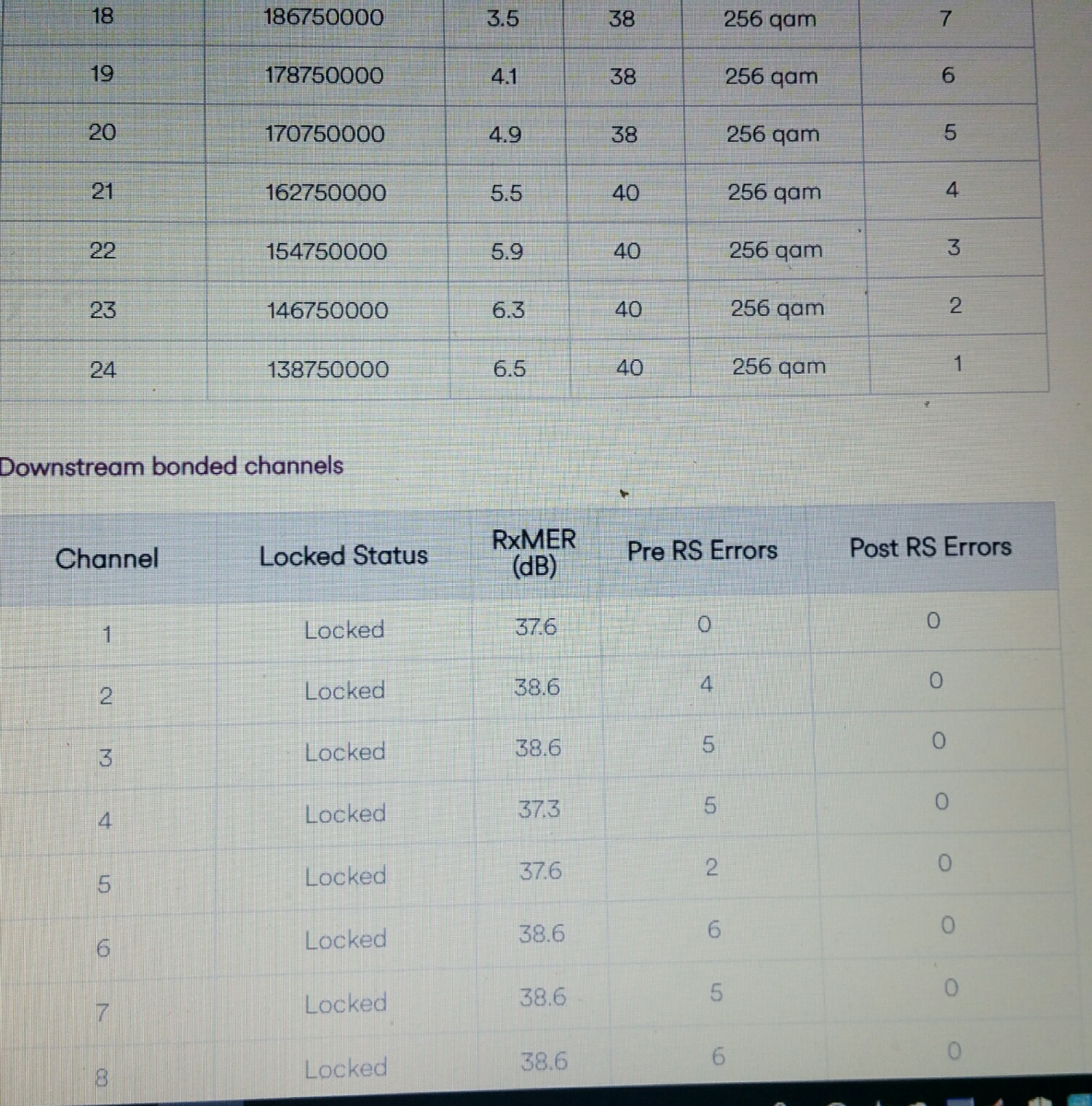

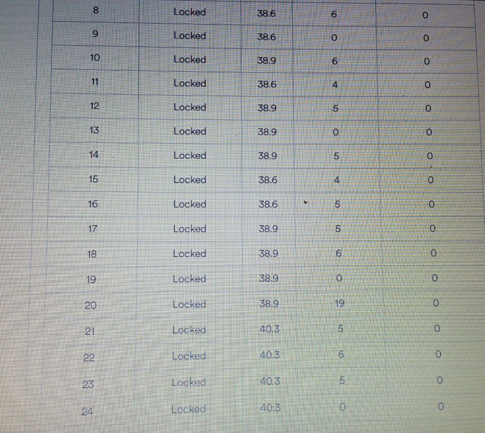

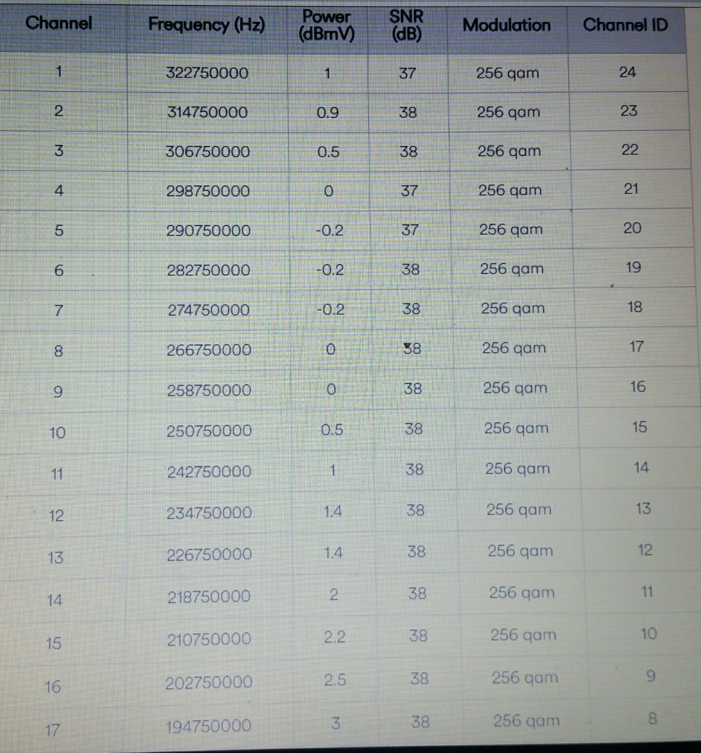

upload your router power logs here, if the fault is with VM like the last one, you can save yourself buying anything as it's their fault and will probably continue to get worse, if it's not the power levels then it could be something else
here we go
here we go

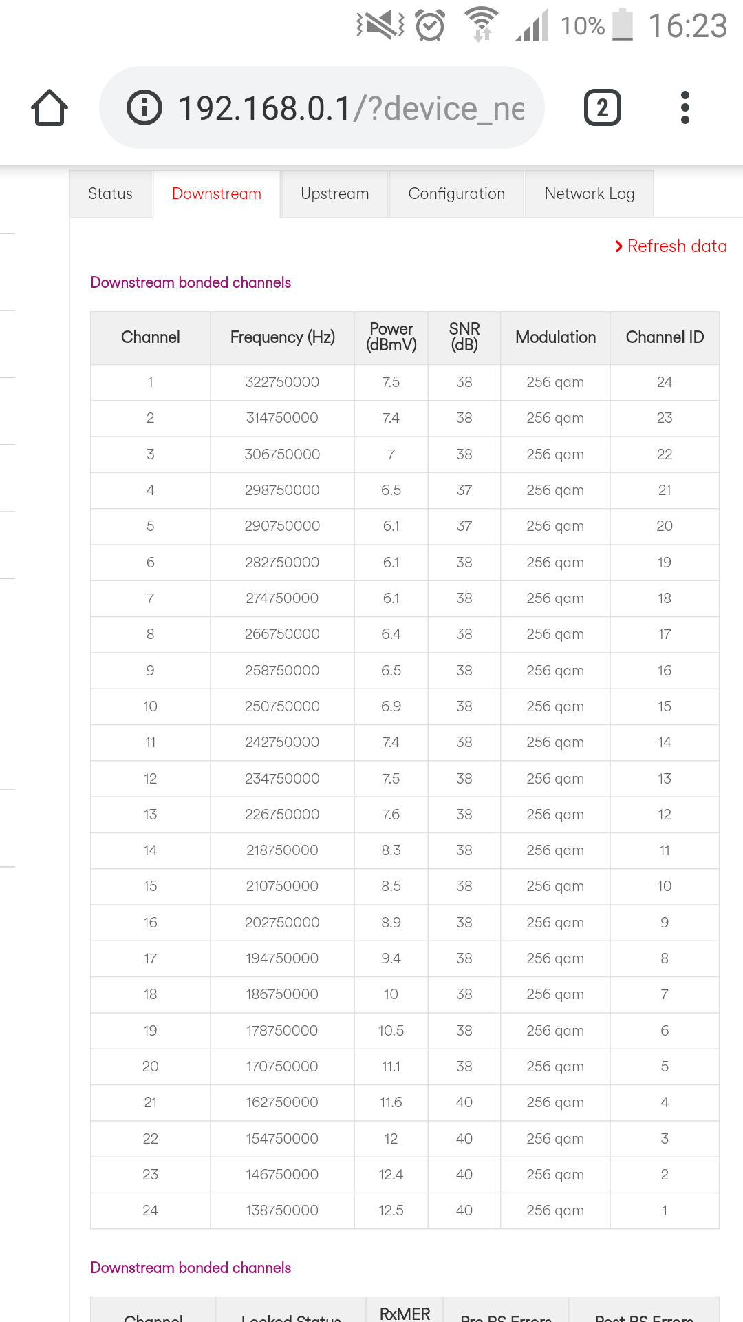

power levels are too high, ring VM and they'll fix it for you

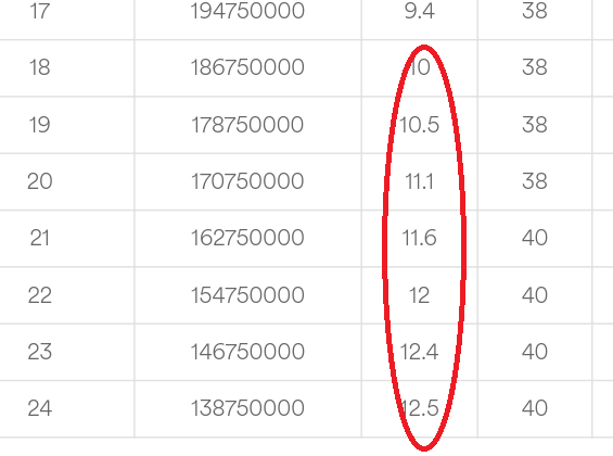

Channels 18 to 24 are through the roof, supposed to be between -6 and 10, so inbetween is about 2 or close to it would be ideal.
channels 18 to 24 range from 10 to 12.5:
