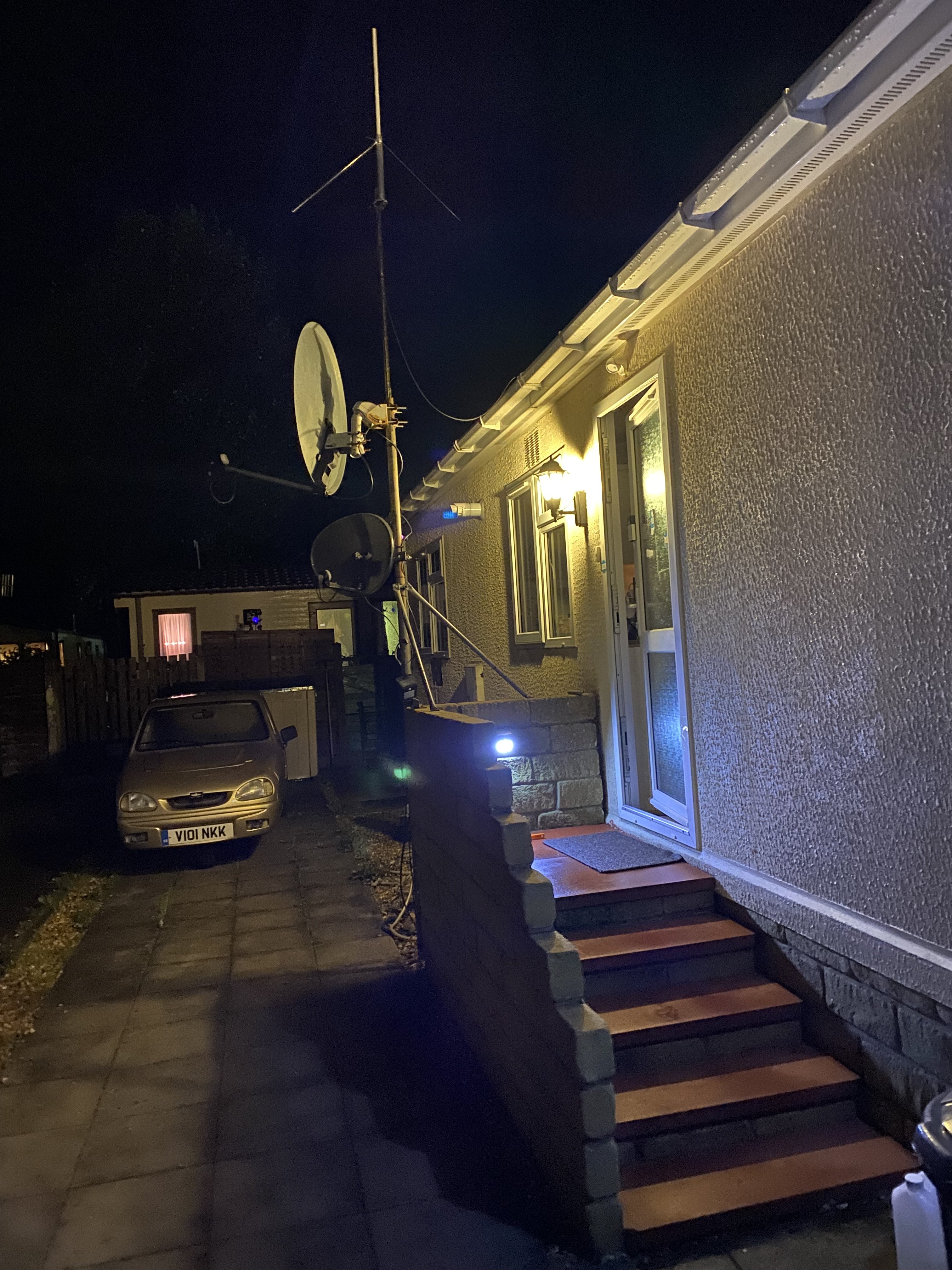

I lost one or two satellites a while back in high wind, I put up with it cos there were still plenty left, then in high wind again lost a few more.
my builder changed the lnb over for me to a stronger inverto black and got a few back.
the satellites I still receive (though weaker signal that previously) are..
28e, 23.5e, 19e, 16e (just), 13e, 9e, 7e, 4.8e (no Nordic beam), 0.8w and 5w.
The ones I’ve lost are..
30w, 4.8e (Nordic beam), 26e, 36e, 39e and 42e.
I’m wondering if this would be something I could solve myself, or my builder cos he’s better up ladders than me lol
I’m absolutely brassic at the minute so thought I’d ask on here first.
I’m wondering if (to the experts) it sounds like either the motor has moved or if it’s an elevation problem?
Or maybe something else?
I wouldn’t have thought it’d be a pole problem cos I’ve got heavy duty brackets and a scaffolding pole and it’s never moved in the past.
A few details, not sure if it matters..
1m dish, technomate tm2600 m3, inverto black lnb, Gigablue receiver using Diseqc, N Manchester.
Any advice greatly appreciated.
thanks.

you try getting one that deals with motorised dishes most only deal with bloody Sky or if you are lucky a static dishIm not sure the builder is the right guy to be peaking a signal mate. And what he going to charge you to try.
If your not confident it might be best to get a sat installer in.

Mine has to be up high unfortunately, I’m surrounded by other houses.oh by the way how high is you dish off the ground there is no need to have it up in the sky subjecting it to gale force wind mine is on a scaffolding pole about 3 meters above ground level and I get every satallite from Hispasat to Turksat
