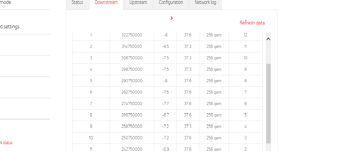

I have been told to buy a 12db attenuator and see if that works if not try the Konig 29db booster
Can you see this helping ? I am not sure how to check my signal strength

An attenuator will only help if your signal level is too high as they lower your power levels.
An official VM HDU unit is supposed to get your signal levels the exact spec for running through VM equipment.

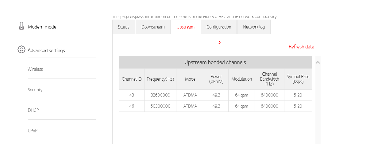

You can check your power levels by logging into your router.
Power levels are too low... -6 is the lowest end of the threshold as it should be between -6 and +10 ... You definitely don't need an attenuator. Change splitter, check connections and see how you go. Poor quality long cable runs wont help either.
