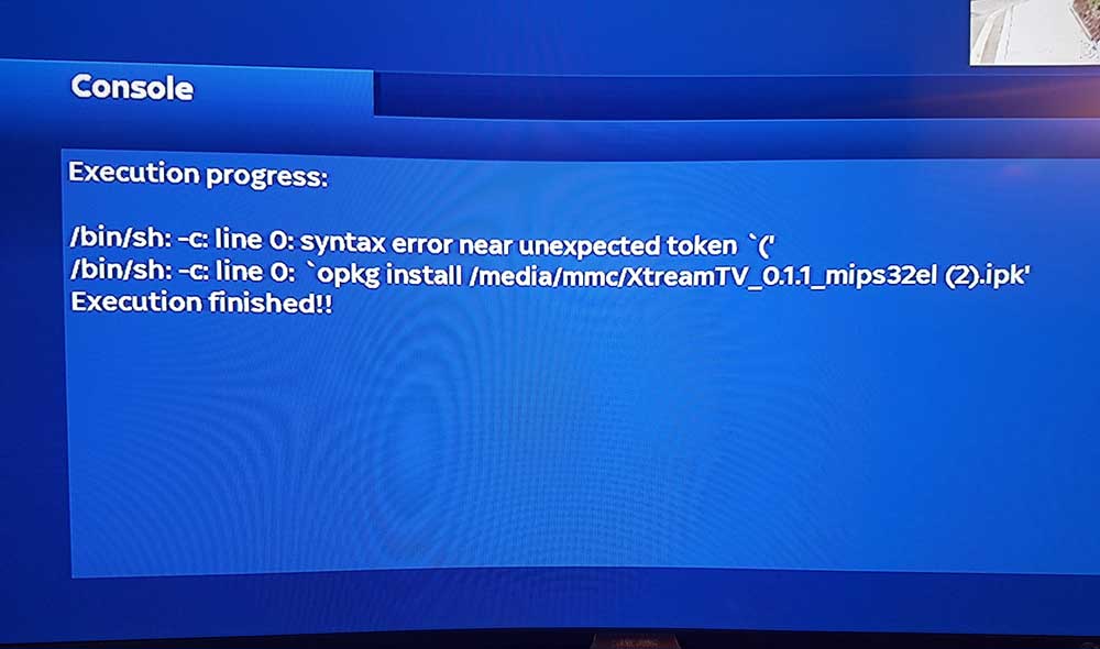

I am getting a syntax error when trying to install a plugin xtream tv on a Zgemma H9 with the Wooshbuild Infinity image. Any idea on what can be causing this? or a solution would be great?
when you downloaded the ipk, you must have already had it, windows has renamed it filename_mips32el(2)
It's this numbering that has caused the problem, rename the file without the (2) or (1) as the box doesn't recognise it
The h9 series is an arm processor, it looks like you have the wrong file.
Contact your provider and ask them for the arm version
