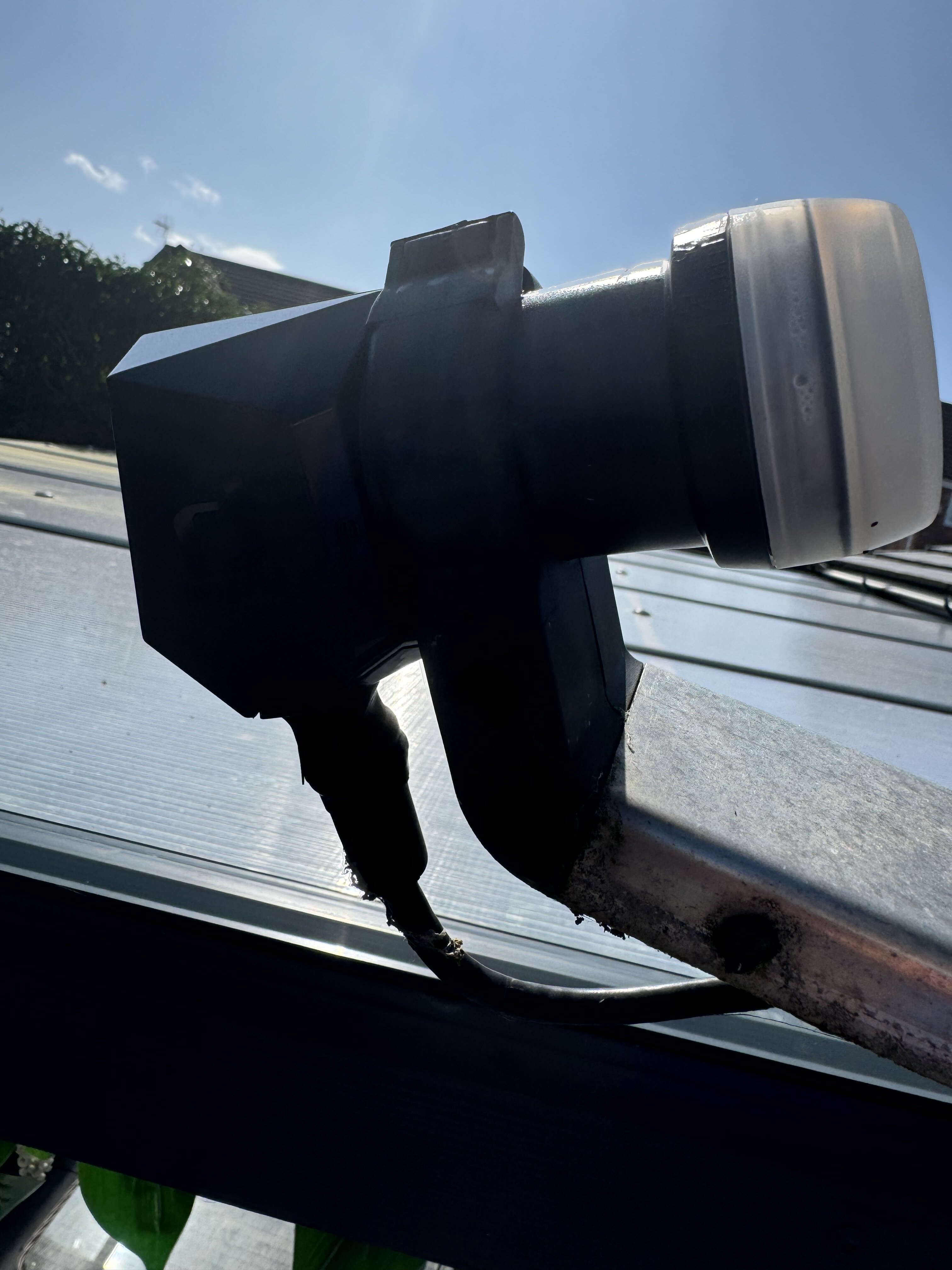

I cant figure out that bit at end of lnb. I have the inverto black ultra quad and my initial look makes me think lnb needs to be pushed towards dish face. Here is a pic my ultra, note the fact the back is at the end of lnb holder, this is a traix dish and looks similar to yours.

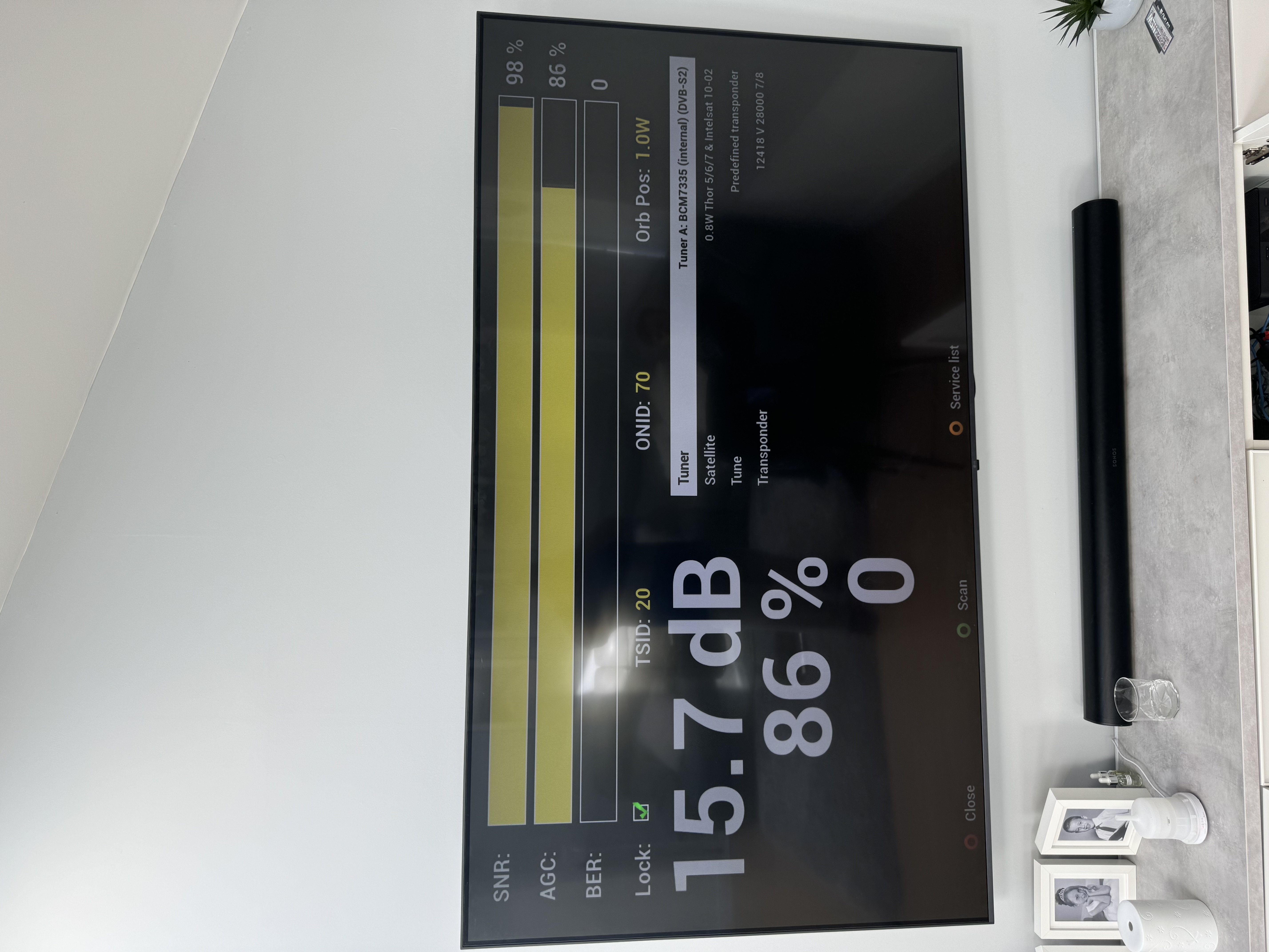

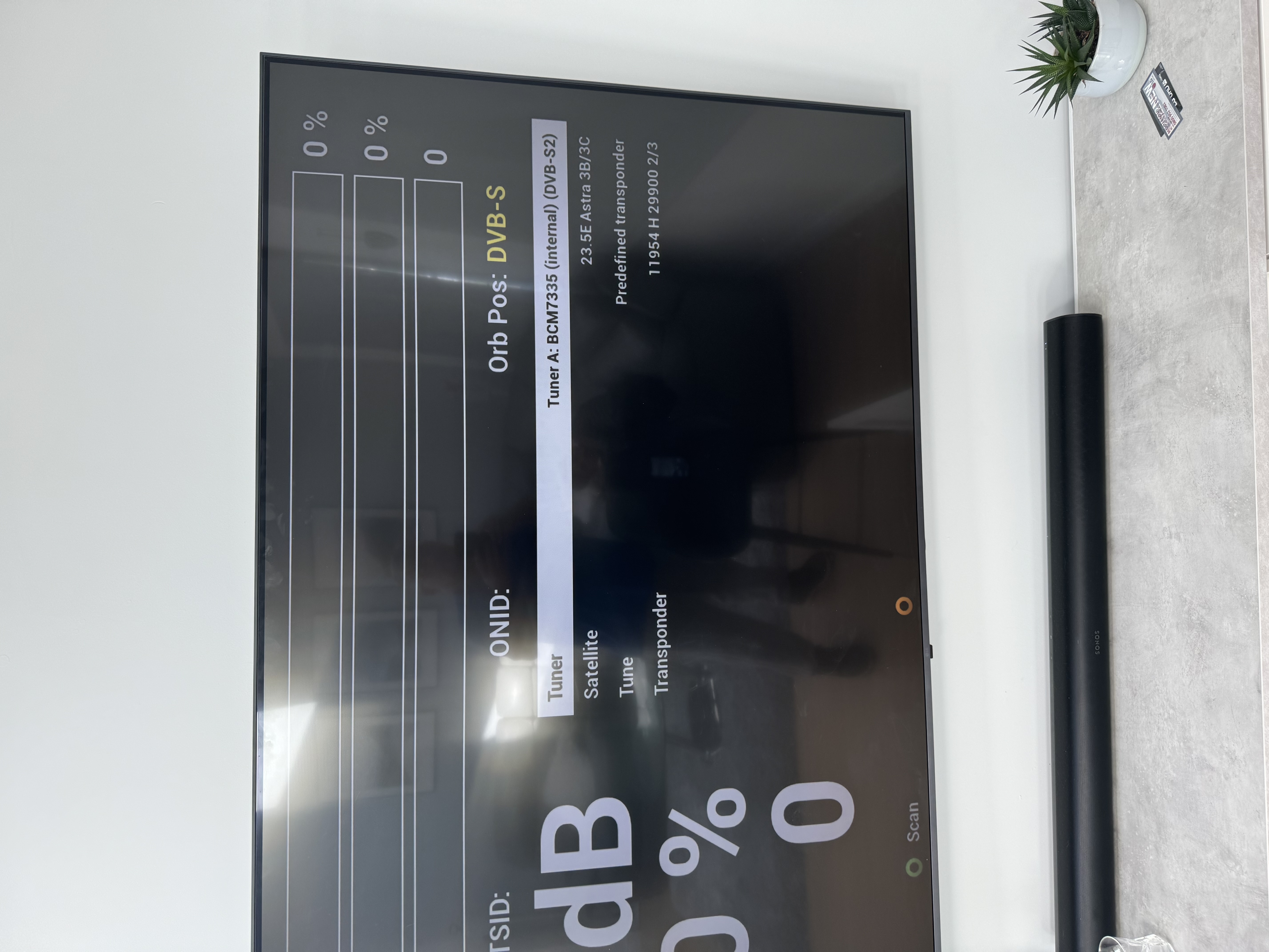

I’ve move the lnb in/out, it’s now as close to the dish as poss, still no signal, I’ve stepped west/east on fine movement in the positioner in menu, no signal. I’ve loosened the elevation of the dish & moved it up/down, no hint of a signal. Good signal on Thor using signal finder in the settings. 🤯. I’m in Liverpool, anyone recommend someone local to me to come & service it?

Hi mate, been a bit busy, reckon I’ve found the problem! A tree in the garden, didn’t think it was coming into play as I was getting 19.2 & 28.2 but when it’s on 23.5 it looks like it’s bang in the middle of the highest point of the tree. Gonna have to get a tree surgeon in now! More money, just as well I didn’t get an engineer in to calibrate it😂Thanks so much for your help 👍
