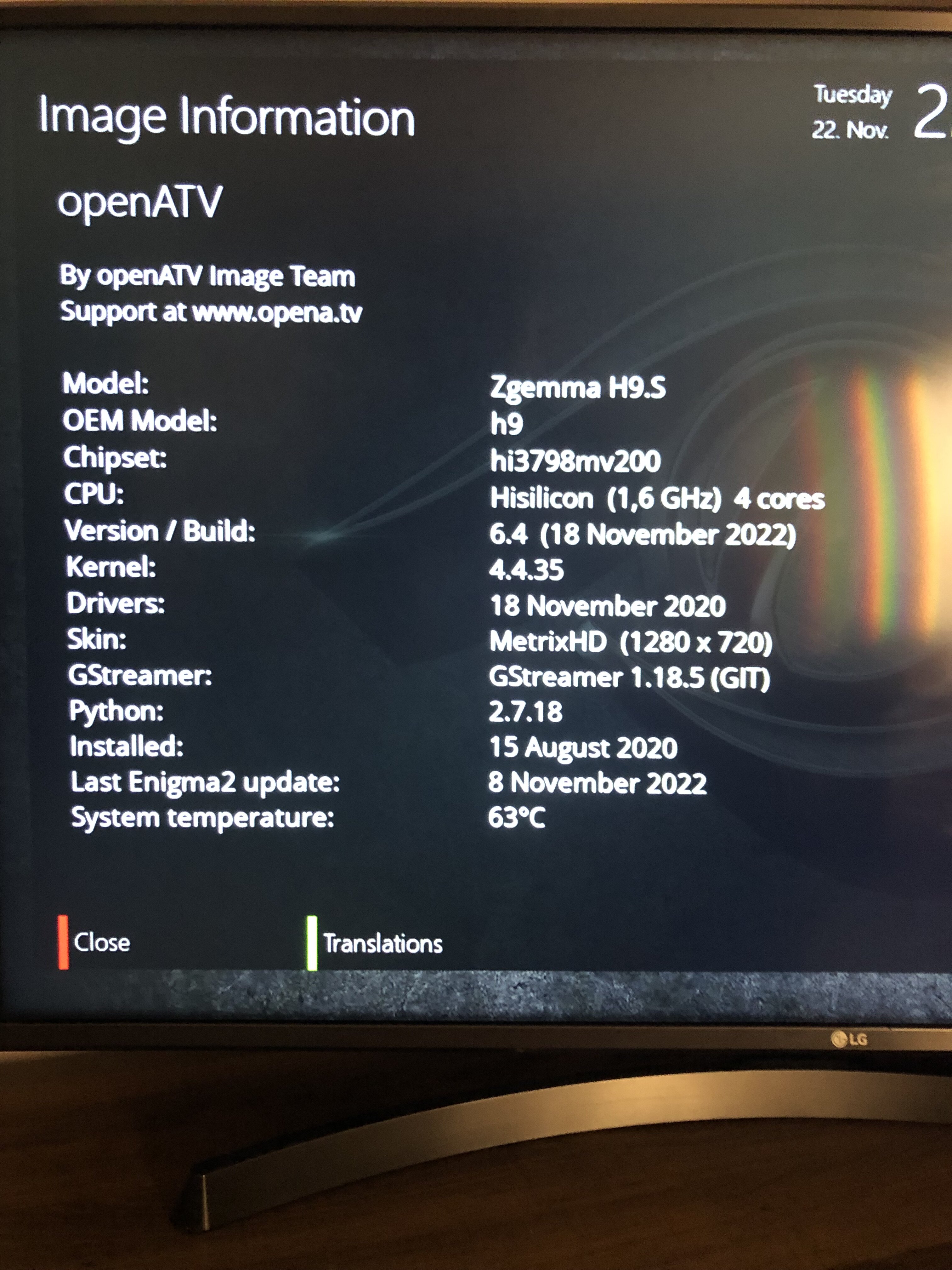

Using remote, Can you check what image you have and post back details of image name and version number/date. Menu, Information, About.

Is this what you're after
It looks like you've updated openatv to the newest image.
If you want similar skins etc to what you had before you may be better with Grogbuild rather than wooshbuild.
Not sure why you had no space unless the box downloaded 3000 updates, it would have been quicker and easier to reflash than update such an old image

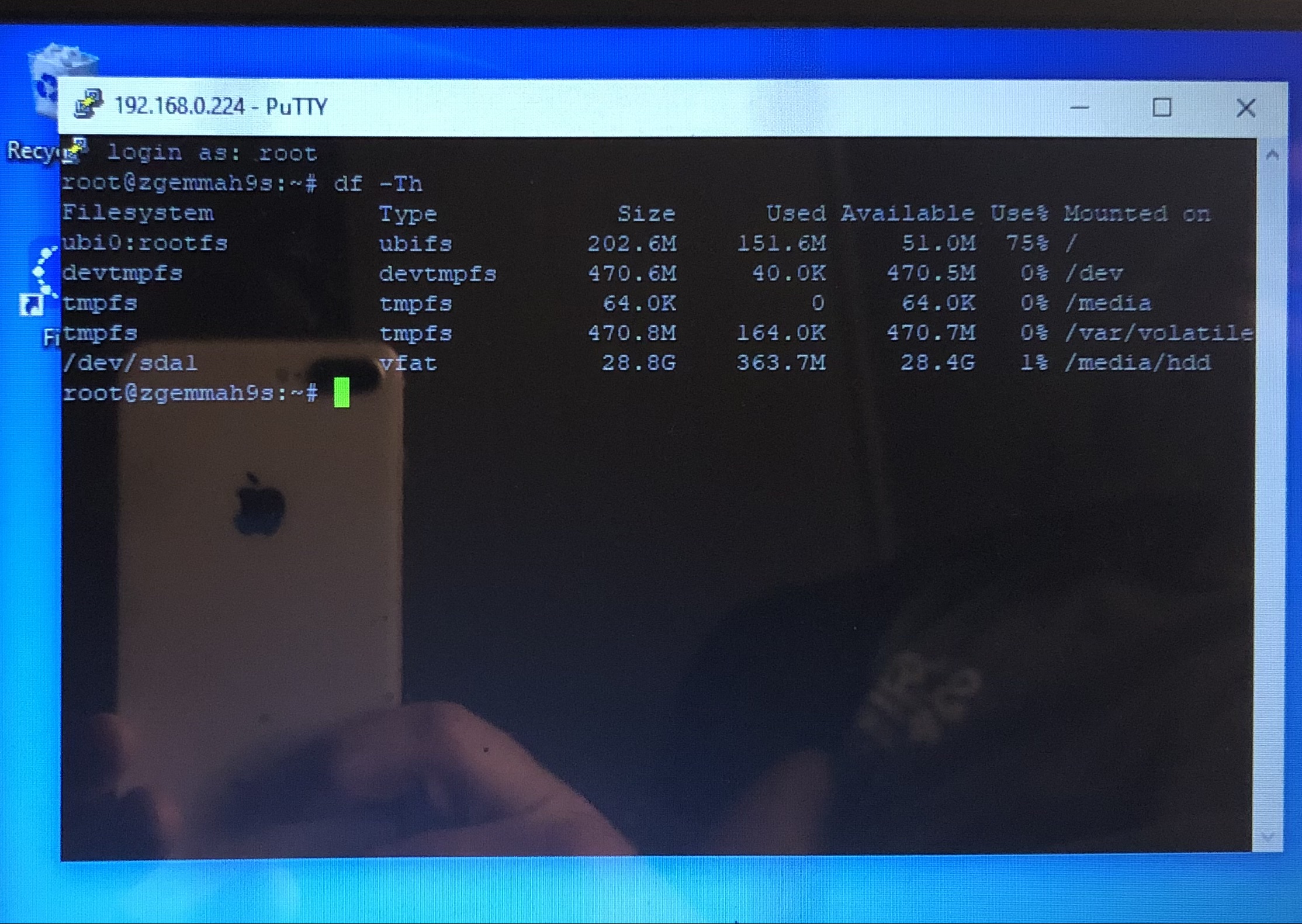

In Putty, issue following command and report back with what you get:
df -Th

Putty output:

2: It seems you installed an image from 2020 using the recovery menu and then applied the 18months plus worth of updates, Not the best way forward.
3: OpenATV 6.4 will stop having updates in a few weeks. It is the last ATV image to use python 2.x. ATv 7.x uses python 3.x. A few plugins have not been updated to python 3 yet.
4: Your USB device is not in a linux file system You only have used ~350Mb out of the 32 GB.

1. Backup files to PC first, then format/initialise your USB device so it is in a linux file system. You will not be able to hotplug into a windows machine.

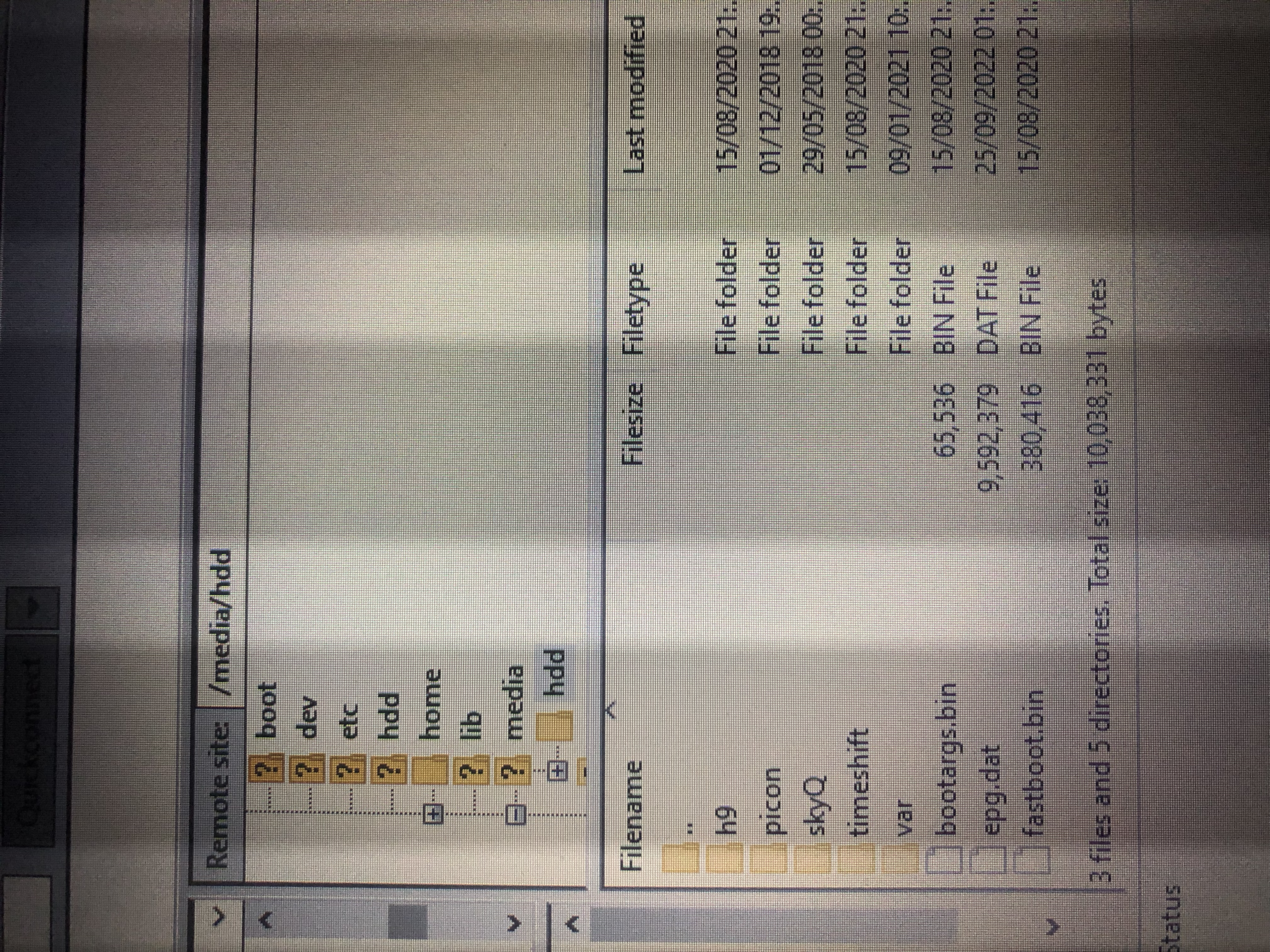

I believe this is the USB directory:
Sorry for image quality - taken from iPhone
Anything there you think I need to keep?

Nope. Initialise it using the remote then it's ready to be used to store temp flash files, you can either flash plain openatv online with the remote or Grogbuild via command line

No unless you have this set up on satellite as well and have clines etc.
