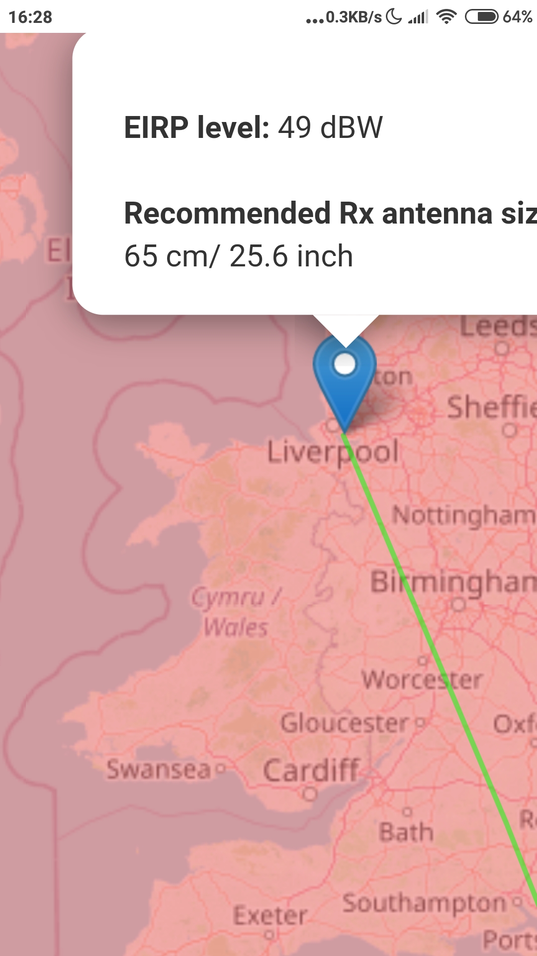

Satbeams - World Of Satellites at your fingertipsHow do I workout dish size footprints for 16.0e iknowvthe bigger the better.
Select 16 east and the Beam Europe A B C D
Zoom in and click on your location.
Its a guide not always accurate.
Yeah its a guide and the info it gives is in ideal conditions.View attachment 96241
I know I need bigger than 65cm based on when the bad hits. Won't get away with another large dish so 80cm will have to do
