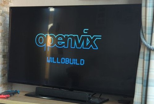

We then took the box downstairs plugged in sat feeds without any ethernet but when we boot back up we are just stuck on this...
We have tried powering the box back off and on but still the same.
We have then tried reflashing willo over WiFi which appeared to work but it then never got past this same screen again?
Yes when cams dont run your left on the splash screen , i would imagine buttons work on remote and can see changes on screen.
If network is working you should be able to select a sat channel and picture displays ?
No button are responsive ?
Like menu button ?
Set up the box with a hard wired network connection. Don't worry about the satellite wires for now , you can connect those later. @Willo3092 can put me straight if his customisation process requires the satellite wires.
Just out of curiosity, does the wi-fi device work out of the box or did you have to install drivers?
