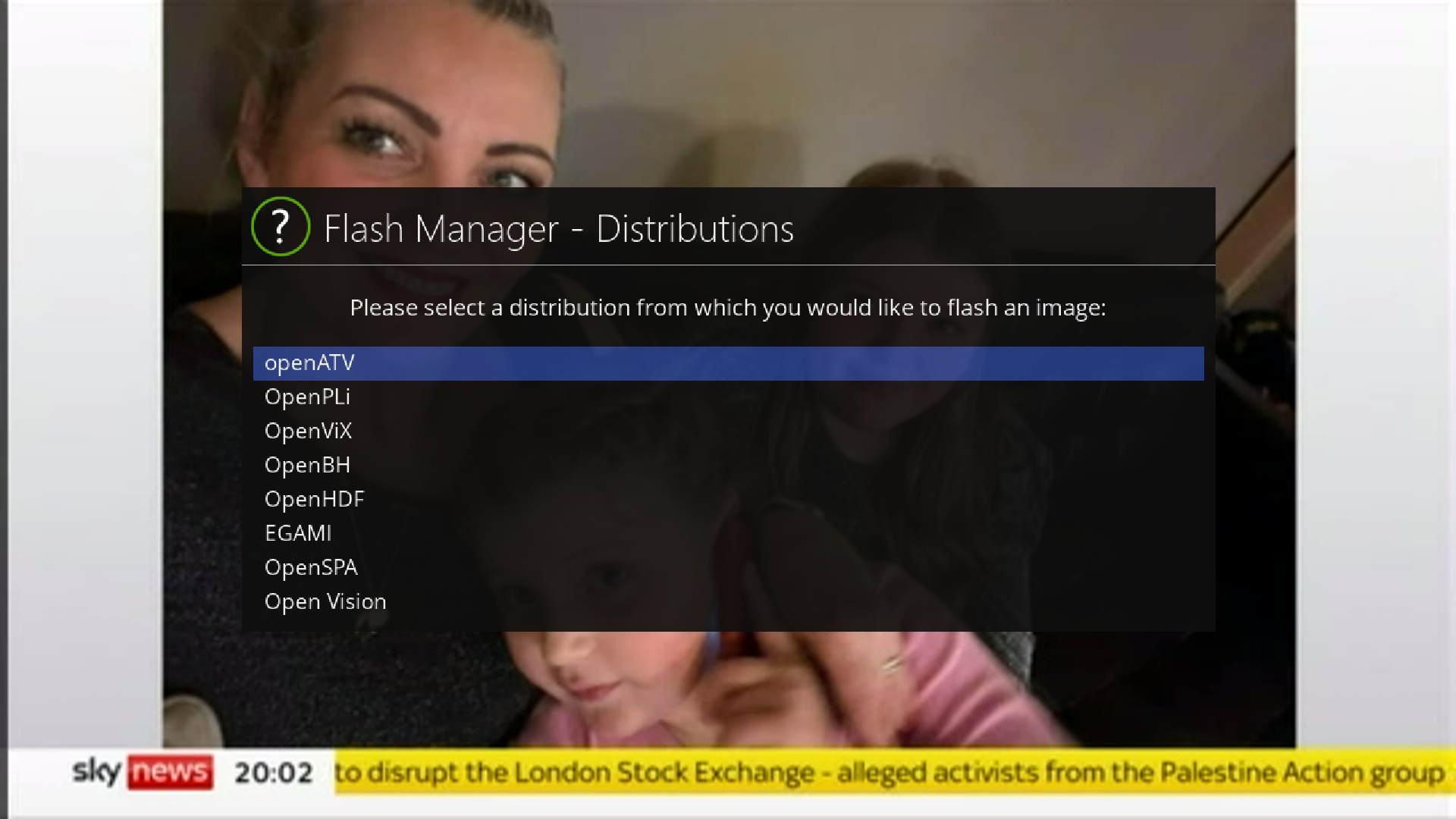

Dont use openpli .With open ATV your insall plugins are set like Attached file
I wouldn't mind installing OpenATV -I had it on a receiver previously - but I cannot find an option to install it from the OpenPli edition I have (Which I believe is a home-built)

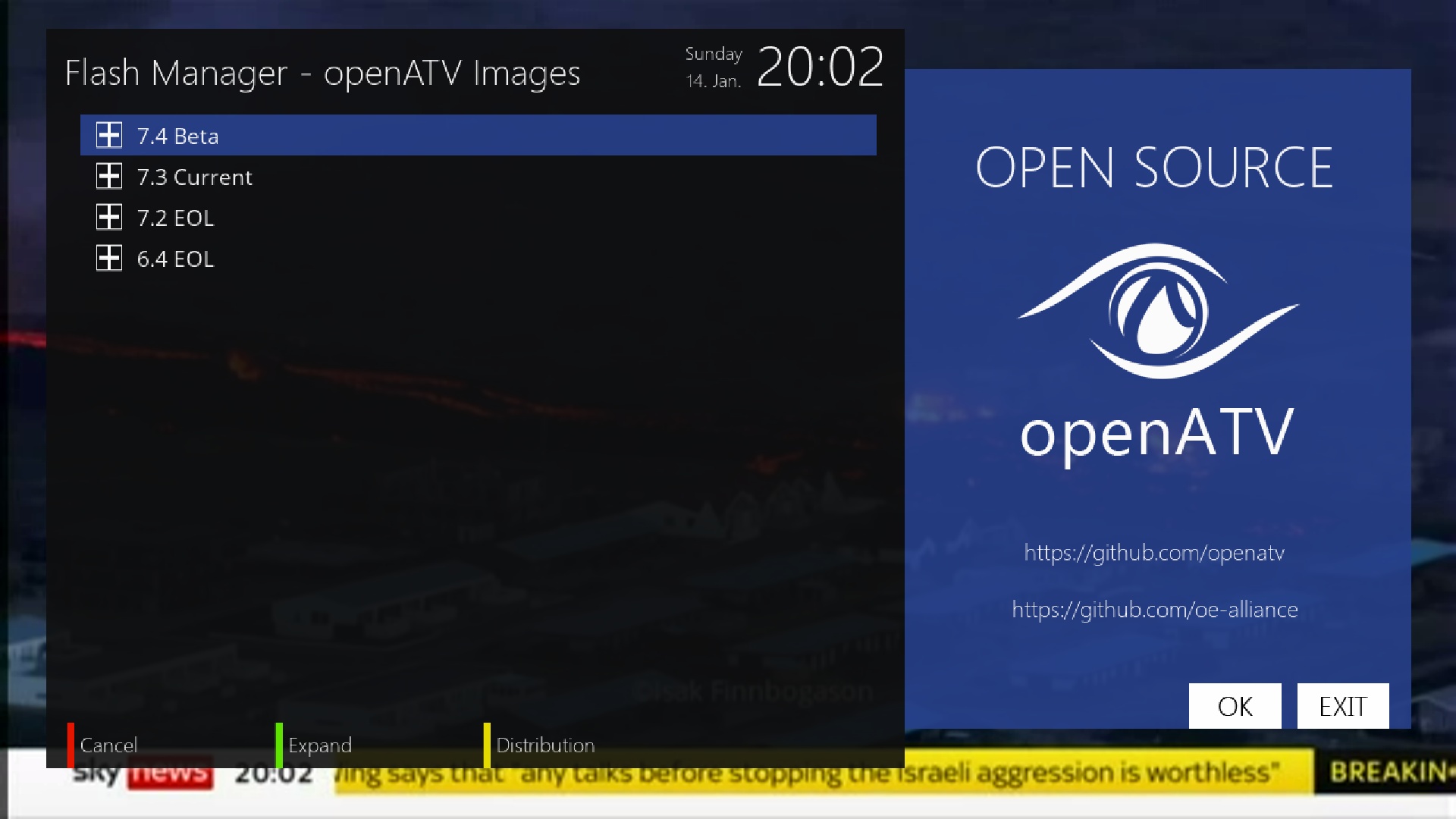

You can flash any image via the remote, press blue button.
Flash online.
Click Yellow for Distribution
Flash online.
