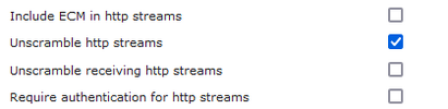

@weimaraner95 just to confirm, you have your system settings as follows:
You also have your supplier's sky card CAID noted in oscam.conf , and in oscam.dvbapi as well?
