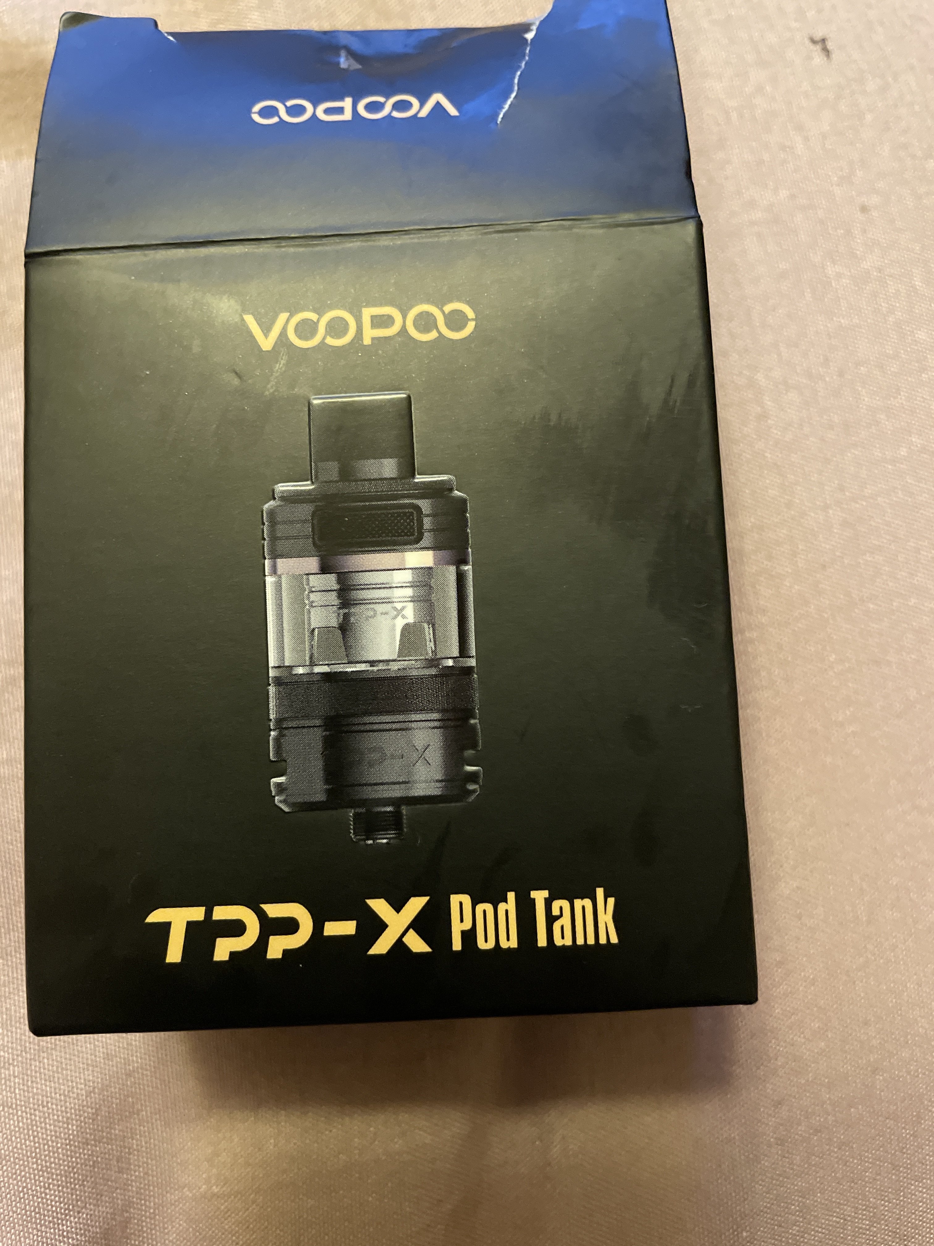

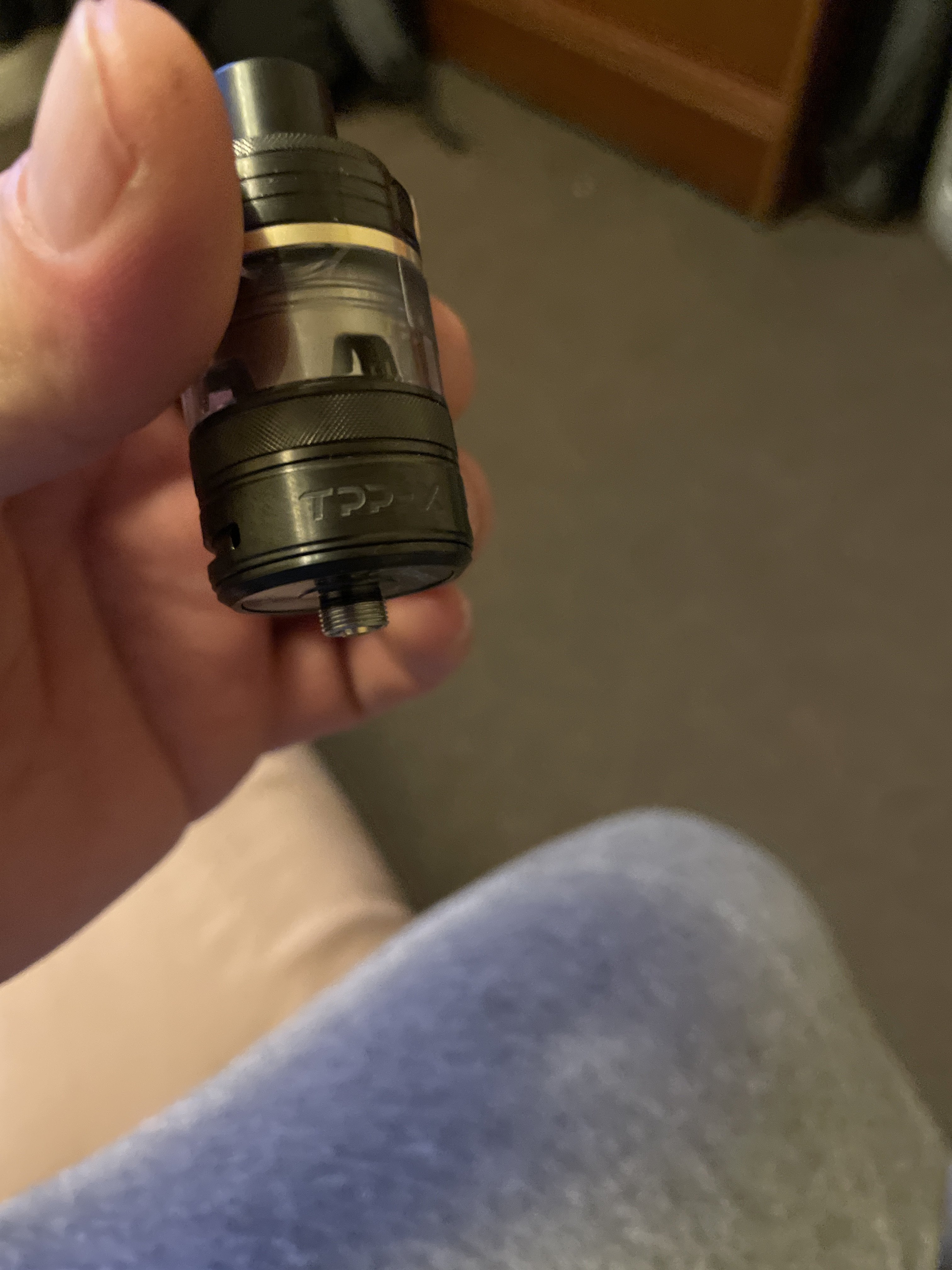

I need a bit of help guys ive bought a voopoo tpp-x pod tank but it won't fit any of my mods it says atomiser short can some one link a mod it will fit on here is box and the actual tank.
Its as tho the screw in bit is too short for my mods
View attachment 72414View attachment 72416
Which mod are you trying to use?
In the bottom of the threaded hole is a flat screw head, this can be undone slightly - about half a turn -to make the connection higher up.
Don't stick tinfoil down there as live and neutral are mm apart
Looks like standard 510 pin connection should fit any mod with a 510.
It won't fit pod mods because they use a different system to connect, usually magnetic on pod mods.
I think it has I will check
EDIT There's no screw head type in bottom
You can pull it apart so you get the magnetic which is why I bought it for my voopoo as its newer tank to what I have
