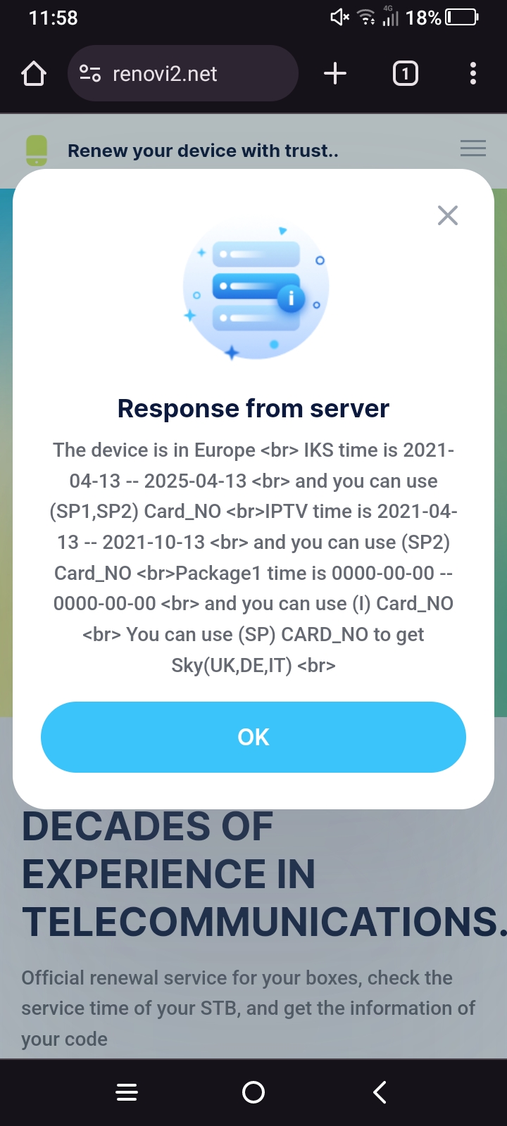

This is the website for checking Spain boxes - Renew your device with trust
Click on "SN Validity" & enter your serial number, if it gives you the boxes server details then you need an SP1 SPAIN renewal.
If it says, "Response from server, Error,Invalid SN", then you need SP1/SP2 Europe.
