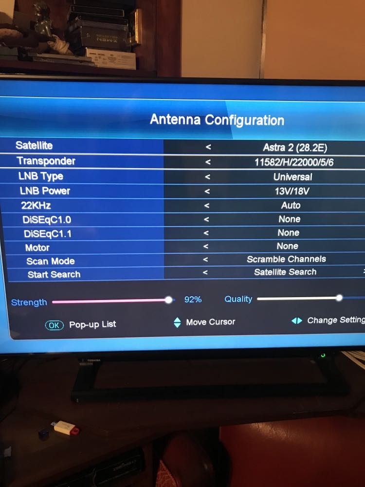

I don't get the ADD option.
If I press OK I just get the drop down list with the set frequencies.
I have tried all the buttons that I can think of on my remote but nothing changes anything.
This is what I get in Antenna Settings
Press menu, then installation, antenna configuration, select the transponder press ok. a drop down list appears, what i did was scroll to the bottom. then use the left and right arrows to drop down to the line underneath where the add button is. click on it and add a transponder. All i needed was freq, v or h and the symbol rate which was 23000.
Thanks to you and Drox that worked, I only ever watch TNT Sports 2 HD but it brought all the rest of the TNT Sports HD ones in too :blush:
Not sure why blind scanning not picking those channels? I tried on both Viark and MS and ended up adding manually. Would have expected blind scan to pick those channels.
