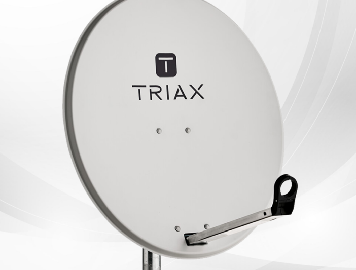

Example dish
That dish will require a Lnb with a 40mm collar
Think your getting a little confused
When it says requires a 40mm collar it means the width of the Lnb
Unless your looking at a second hand dishes and they are missing the Lnb holder I wouldn't, go near them .
Example dish
