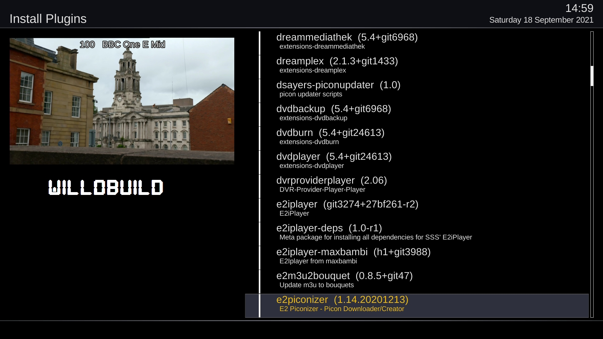

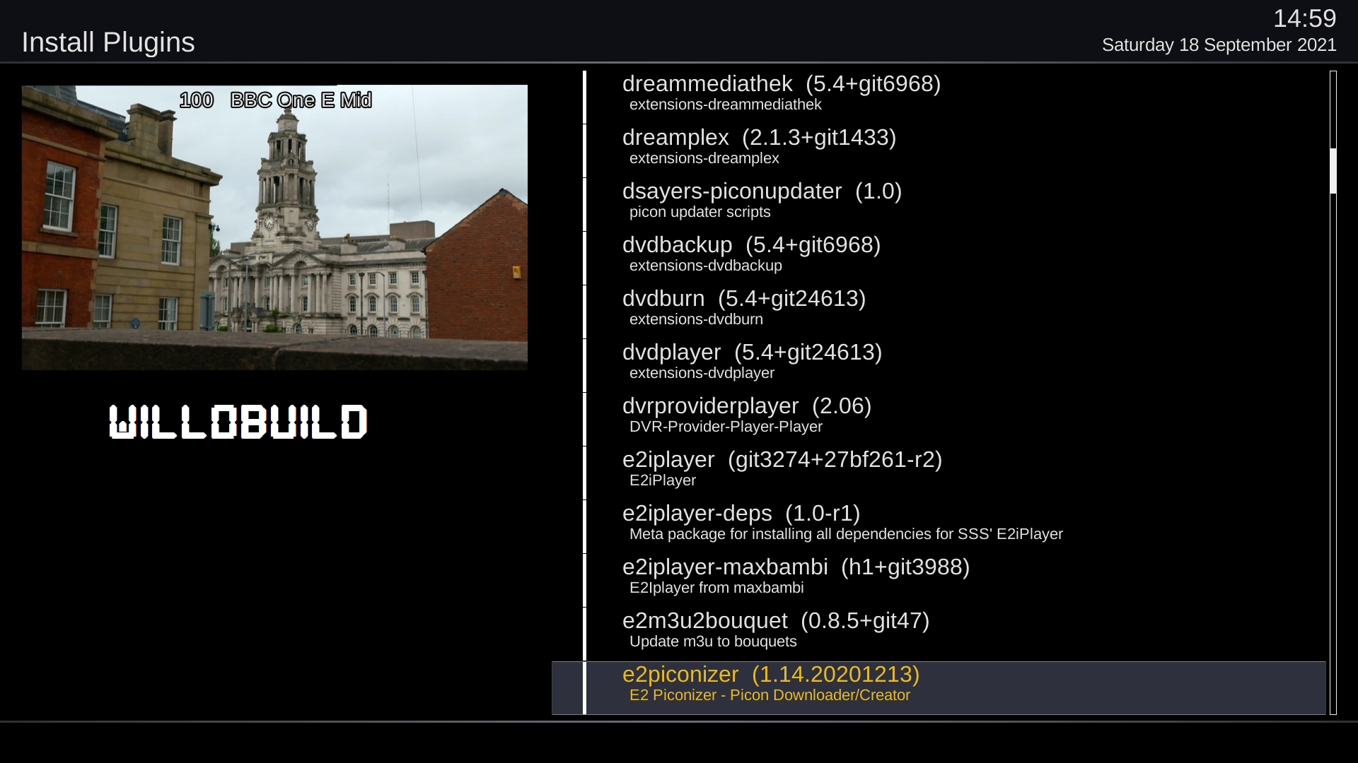

If dsayers picon updater doesn't bring in the missing picons try epiconiser in the plugin feeds.
I'm either stone blind or it's not in the plugin field. I ran dsayers picon updater but still missing , its just the 4 Irish channels.
Not a big deal, build is working well.

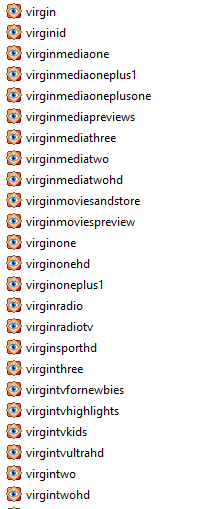

rename them to whatever the channel name is such as virginmediaone.png.
You might have to restart the gui before they show.
What location do they get read from.
They downloaded to the epiconiser download folder and I renamed them.
I'm guessing they should be moved to the folder "picon" on the hardrive , but when I ftp to that location I don't seem to have write permissions to copy them
I never use ftp, just put the ip address in windows explorer preceded by \\
\\192.168.0.xx
That worked , all the Irish channels have picons now.
