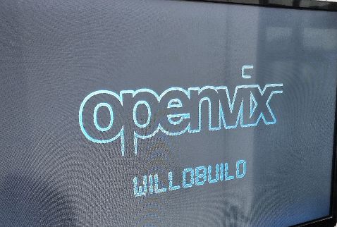

I have not touched my setup since getting the help here in August to move to WilloBuild. I had my Formuler F1 box plugged out off for a while as I had difficulties turning it off. Powering it on earlier (a few times) it's hung. What can I do?

This is a setup that has worked for years with original power supply. Has anyone ever seen a working setup dies like this?
If I have a box that hangs, I always power off and disconnect storage and see if it starts then.
I did all that before posting. It's been down a good while now :-(

I went through the box of tricks in the shed. I've about 8 or 10 PSUs, invariably they are not the right voltage or end connection. I found 3 12v ones and was stunned to find that one had the right end connection! It never happens. That confirmed that the old PSU is fine as it hung on the same startup spot. So has anyone ever seen this happen on a formerly working machine where the PSU is 100%.
Are we sure this isn't just a skin issue? Have you tried to reflash via putty?
I've no idea. I did not change anything. Why would it happen out of the blue? You recommend I try a reflash via putty so.

Yes reflash it via putty or a working USB stick. Do you remember the box IP address if not you can look in the router settings to see which devices are connected. If your box is listed type that IP address into a browser it should open up webif homescreen
