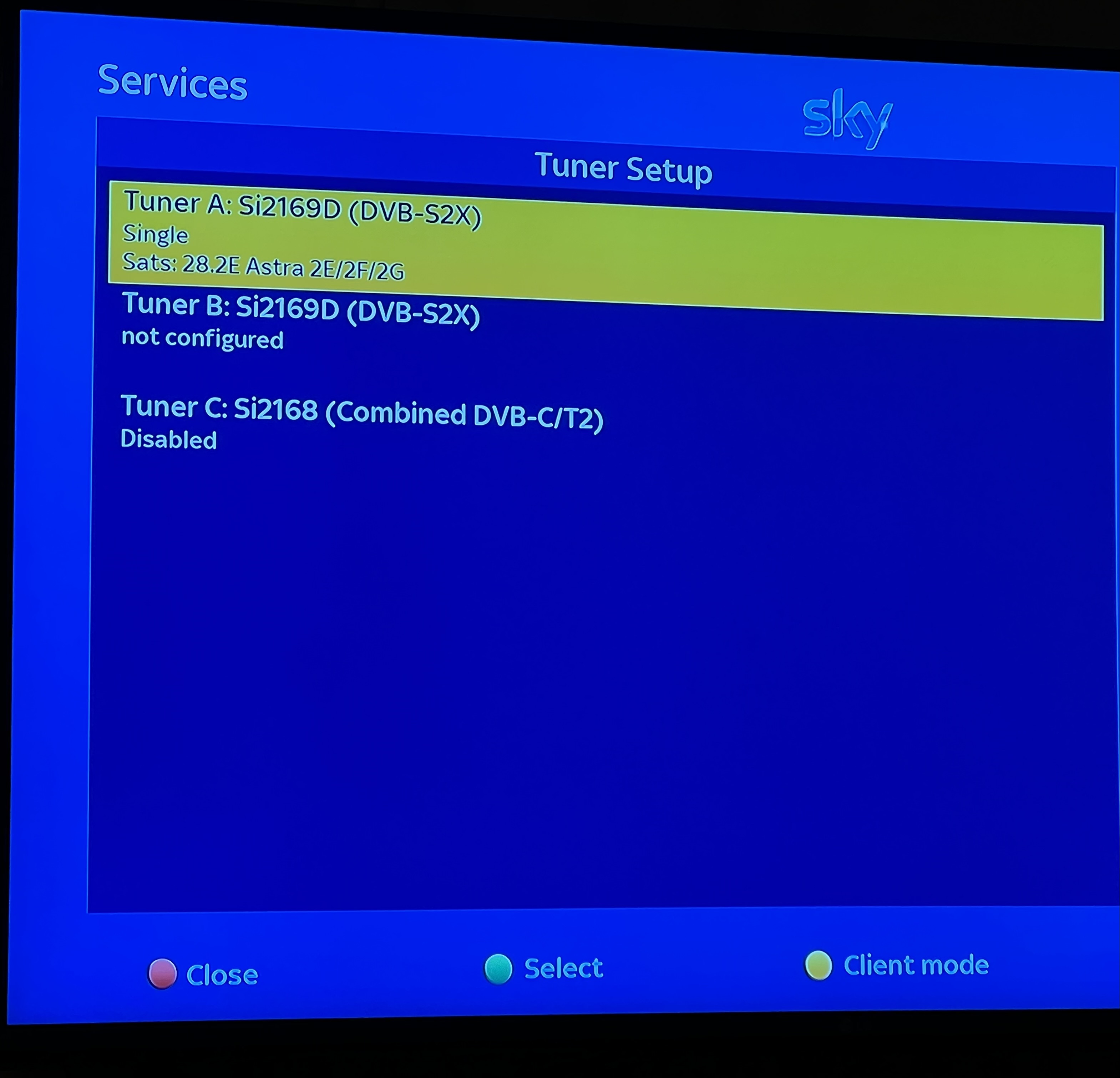

I have disabled the hdmi cec, Tuner A config to 28 , Tuner B and C are disabled..?? Files attached..
You have posted a picture of the tuner configuration overview. Thanks.
You have decided not to describe the equipment connected to each tuner. Nobody can compel you to provide information.
