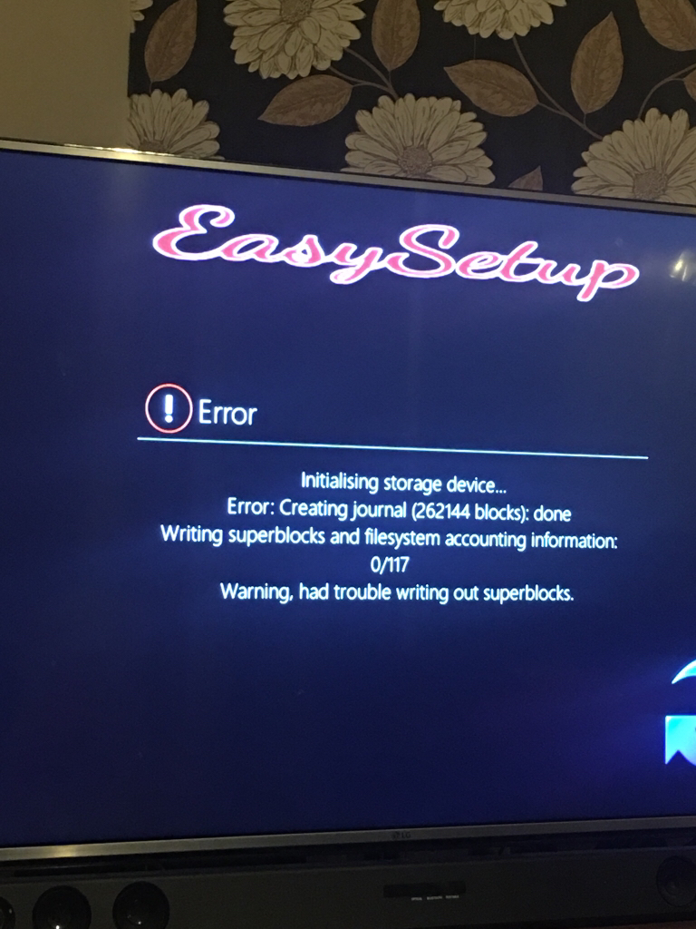

Hi guys having an absolute nightmare here trying to get woosh 7 installed onto my h5t2c downloaded the file using the usb stick I always use got to the initialising hdd part now I have recordings so didn’t want to wipe them off the hdd initially however it wouldn’t work coming up with not enough space on hdd even though it’s a 1tb with about 5 recordings on at most the hdd is about 95% empty
Anyway gave up in the end resigned my self to losing the recordings so went back to the start clicked yes to initialise hdd and now I’m stuck again this time with an error message
I have no idea what the problem is or how to proceed all I know for sure Is other than the sound loss on main event hd everything was working fine with woosh 6 and there was no hdd problems
Any help much appreciated
plug your HDD into your PC and format it to ext4 , if you are using windoze and cant format to ext4 then format it to fat32, and your box will convert it when it initialises it
Any way of doing something that keeps my recordings or is all hope lost on that front?
if you have already tried to initialise it, maybe not,
are you using windows.?
the biggest problem is windows cant 'see' an ext formatted drive,
you could download a LIVE copy of ubuntu and run it from DVD or usb drive, it will be able to see your HDD and possibly extract your recordings either directly or via ' photorec ' if you have already over written them,
it will also format your HDD to ext4 so you wont need to initialise it on your box
