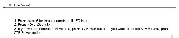

Found this in the manual, might help.

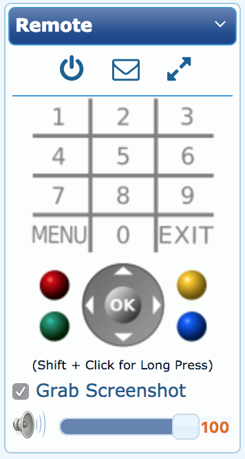

Because the vu remote is set to max volume when first set up. Flashing wooshbuild as set the volume to 55. so unable to turn the box volume up. If you know what I mean
I think its this one.
Hey, update on my situation... I've managed to finally get sound working but messing with the audio settings until I got them on.
Only problem now is that I have to have my amp really loud to hear the sound? Obvious I know that there is probably a volume setting within the vu+ solo2 box itself but I can't find it if so? Volume on the remote just turns my TV up as I have it set to control my TV?
Use OpenWebif to set the volume.
Awesome advice, thank you so much
