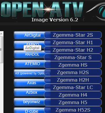

Check that you have flashed the correct image version, H2s, 2s etc are different models

Yes I've already checked that mate. I'm struggling.Check that you have flashed the correct image version, H2s, 2s etc are different models

Okay mate I'll give it a go thanks for your help.OK, check the model number on the front of the box, if you've flashed online or any other way than USB, the box (if renamed incorrectly) will scan for the latest version and flash that, if you have a H.2h that has been renamed H2s, it will download the image for H2s
go here and manually download todays flash files for the box and start again:
http://images2.mynonpublic.com/openatv/current/index.php?open=

I've downloaded version 303 for my 2s and put my usb into rear powered up and flash comes on the front of the box but it just stops like this been a good 15min.Okay mate I'll give it a go thanks for your help.
hi ive done all the above but no luck but I got a zgemma h2s off a mate and used same usb and installed new openatv onto box and installed woosh infinity so my usb must be okay so I feel my 2s box must be shot.you may need to try a different usb pen, also make sure it's formatted (FAT32) before you put the unzipped flash files on there
