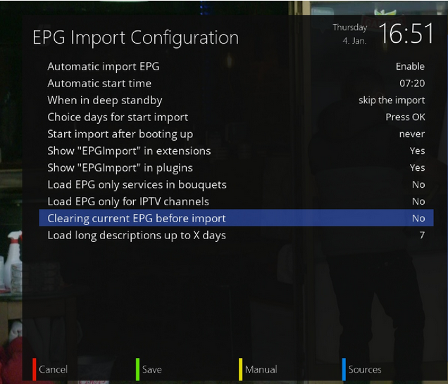

yes as said before it is getting you epg_id's from playlist just epg is not downloading if mostly UK channels in epg importer select items in Rytec UK XMLTV you can also select other entries that may help in Rytec General or even other countries if you have them .
also here is image of general setting for epg importer you can change to suit , but make sure you have:
Load EPG olny services in bouquests set to NO
and
Load EPG only for IPTV channels set to NO
You can also reduce number of days

I did already try Rytec instead of and as well as provider.
When I do use Rytec is imports around 40k events - but they do not populate in the IPTV EPG :)
